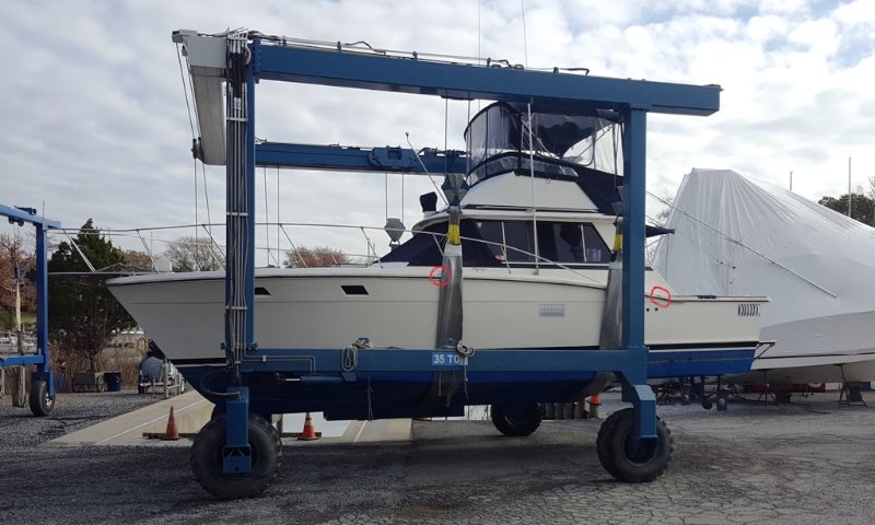

Hi there all you Trojan guys, & gals. It's been a while, but since chatting I have finished the valve jobs on both 440's, they're running well. Today's issue is that I don't understand how the solenoid & cables should be connected to have the starboard battery used as the start battery, & the port battery used as the accessory battery. I have all the original manuals, & have yet to find a wiring diagram describing this hookup. I does make sense to use that setup, so would like the system. Right now I have it setup with each battery starting & controlling each engine, but neither alternator seems to be charging, at least not registering on the volt meters. Wonder if not having the batteries set up as discussed, is not allowing charging. When I got the boat, all of that was disconnected, so not sure of the proper hookup. I would certainly appreciate some help with this, maybe even a diagram if any are available. Also, any pics of the F36 hanging in lifting straps, or description of the strap location for haulout would be helpful, even though it's pretty straight forward. Thanks again for being there, Dave.

Here is a picture of our boat on a travel lift with the factory specified locations circled in red. The travel lift operator was not comfortable with the specified rear location and I couldn't get him to use it.
Sling Locations.jpg (75.44 KiB) Viewed 6552 times

Hi guys, thanks for the mail. The picture of your boat in the travel lift is perfect! Pretty much what I'd have guessed, but always nice to get it straight. I appreciate it. Have a good nite, Dave
