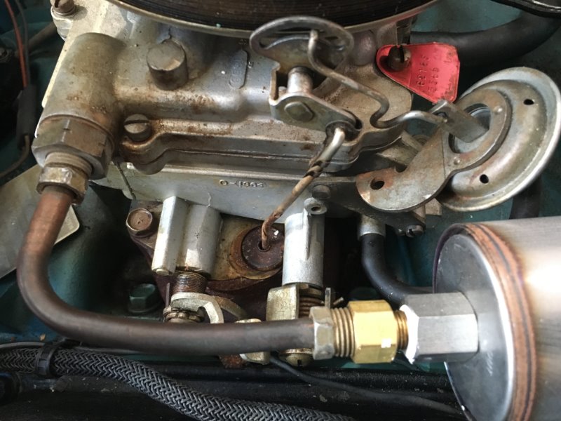

BradZ
Posts: 161
Re: 1976 F-32 Fuel Line Size
Post by BradZ »
I went to Lakeland Auto and Marine in Port Clinton, Ohio and they hooked me up. The use an available inline filter with two adapters to fit the original fuel line fittings. I had to relocate the line support piece but that was easily done with a piece of 1/8" x 3/4" steel flat bar. I have one picture showing the adapter. Pulled the boat out for the winter, always a sad day.
