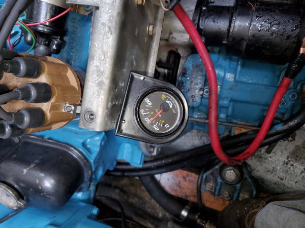

Get this, the lines on my remote oil filter set up were switched. It was fine when I got the boat 2 years ago. And fine at the beginning of last season. I think I was sabotaged. Because the only thing I did with it was change the filter. I never messed with the lines. So, I removed the set up amd put the filter right on the block. I had changed the filter a couple times thinking I had a bad filter, but 2 in a row isnt common. On a whim I pulled the filter amd barely any oil came out. That's when I figured it had to be the issue. When I put the new filter on and started it I got 45psi. I feel like a moron but there were 3 other mechanics that I am friends with trying to figure it out.
- Psi at 1500ish
