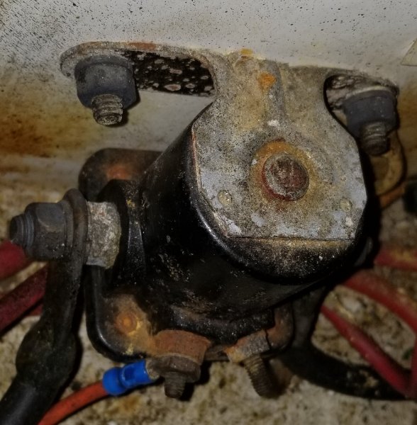

I changed the solenoid on the starter as I thought it was the issue due to the following:
1) using switch at helm, engine wouldn't start, starter wouldn't engage, the beeping would just go silent, if held too long the breaker on the panel would release and I'd have to wait 5 min to reset the switch
2) if I jumped the solenoid with the helm switch on, it would start
Unfortunately, with the new solenoid in, it still won't engage the starter. And now the relay (see picture) in the battery box clicks when I jump the solenoid and the starter doesn't engage.
Any thoughts or suggestions would be greatly appreciated, I'm stuck, and want to get out to enjoy isolation on the water.

That solenoid/relay is for the system that jumps the batteries . The problem may have been the neutral safety switch . But now it sounds like you have a starter solenoid issue too . Bad part or a Install issue ? So likely 2 problems to diagnose and fix .

prowlersfish wrote: Mon May 25, 2020 7:15 pm That solenoid/relay is for the system that jumps the batteries . The problem may have been the neutral safety switch . But now it sounds like you have a starter solenoid issue too . Bad part or a Install issue ? So likely 2 problems to diagnose and fix .
The relay/solenoid in the battery box clicks when I jump the starter Solenoid. So if the neutral safety is faulty, the starter solenoid won't start, but if I jump it use to turn over and keep going. How would I test the safety switch?

Re: Engine won't start - clicking from relay in battery box
Never seen (heard?) a clicking relay that was not due to low voltage. Don't just check battery voltage, check connections for continuity. Also, check voltage at starter when cranking.

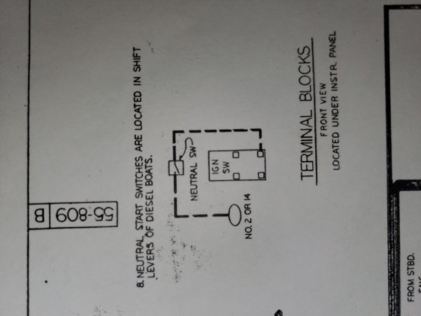

If u wanna check the neutral switch, pop the cover off the shift lever box. There should be a switch there according to Google. Which I think is funny. The neutral start switch outta be on the tranny. Three Mile Island disaster was caused by signal to close the valve also being the same signal that said " valve closed". Well, signal to close valve doesn't mean the valve IS closed. But I digress.
Take one wire off the switch. Check continuity when in neutral, and when not.
Its normal for a relay to click when activated . When turned on or off you may hear a click . Am I understanding that it would start jumped at the starter solenoid it would start then you replaced it and no longer does ? The solenoid is on the starter . You also may have a starter relay on the engine . ( you never said what engine) Did you look at wiring diagram ? Like P-Dogg said Low voltage could cause issues .

For the neutral safety, would the engine start and continue to run when I jump the starter? Trying to figure out if I can reduce the number of possible issues
Back to your OP first:
By "clicking," do you mean "click," or "click click click click click?" I think you've got Prowlersfish confused......
As for the neutral switch question, you've got a wiring diagram, right? I pulled mine out. Looks like all the neutral switch does is prevent starting solenoid from engaging. Think of it as an "and" gate or switch. Ignition AND neutral must pass current for relay to engage. Thus, if you hot wire the starter and get it to turn over and run, it should stay running when you remove power from the starter irrespective of condition of neutral start switch.

Correct on the neutral safety switch . Perhaps I am or am not the one confused :shock: on the clicking ? :) But a very good question as it can be taken both ways . I took it as a click each time not as multiple clicking while holding .
