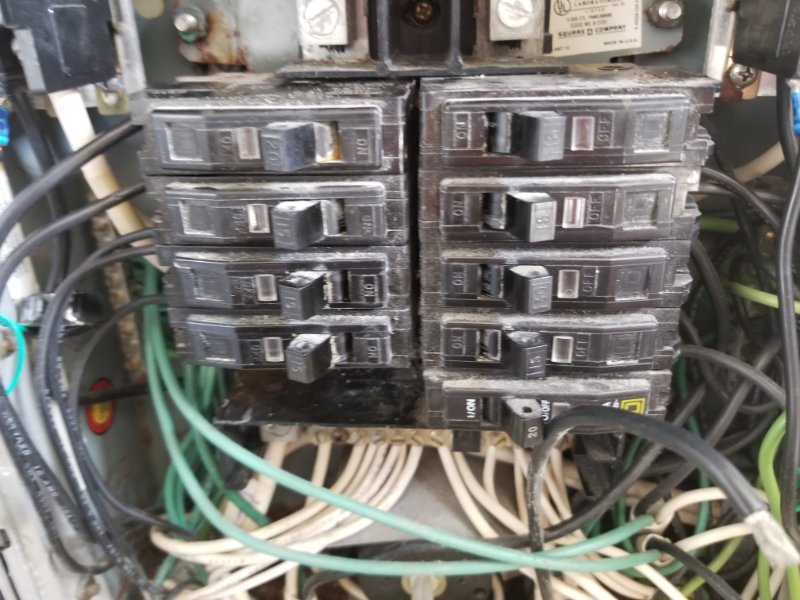

Do you have the factory wiring diagram and is it still accurate? If so, can you post a photo of the AC panel wiring and I will be happy to look at it.

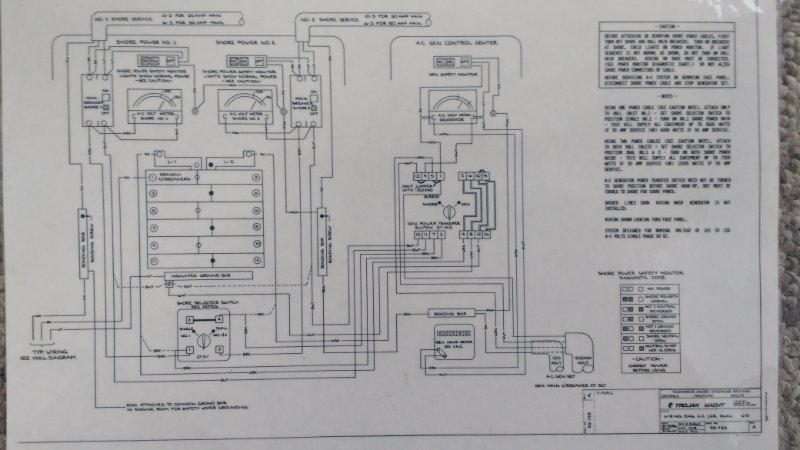

I hope i attached the file correctly of the A/C wiring diagram.
with the shore selector to line 1 and line 2 main breaker off, it would seem that line 2 white and black or not in the loop, only that green is going to bonding bar. I'm not very good at electrical but could it be a difference in in the green between the two power cords?

Ramblin, I can't read the fine print on the schematic you posted. If there is any way to get a clearer copy, that would be great! Also a photo of your AC panel if you have it.
El L Sea, if you have a single power cord, having all the neutrals tied together is correct. If you have two cords, you cannot connect the neutrals together without risking the pedestal detecting a ground fault and tripping the GFCI.
