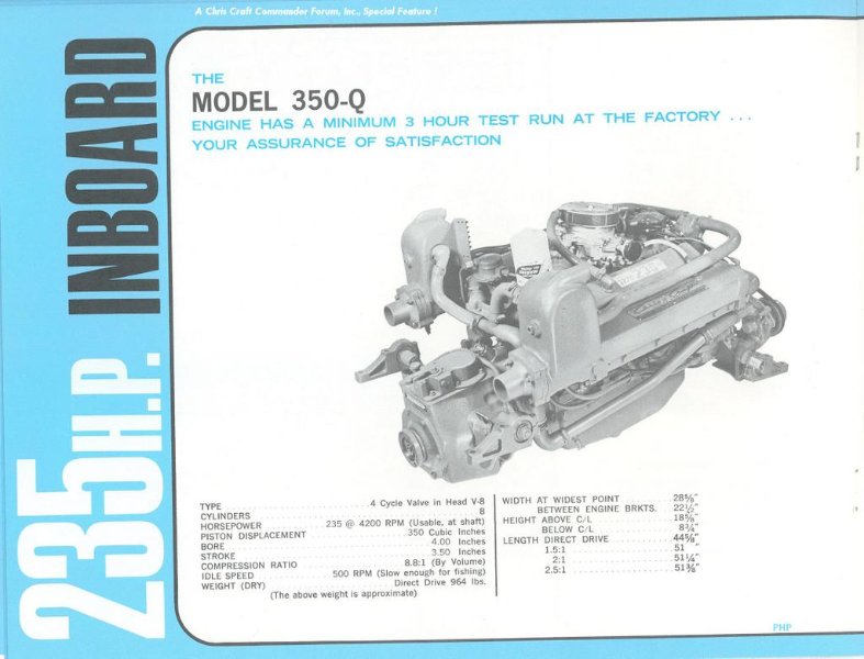

Trying to help a friend... anyone know where I can locate a distributor for 350q right hand rotation?

GM in most cases are the same right and left hand . 350Q ? meaning a Old ChisCraft marine engine late 60s- early 70s ? if it is all bets are off as the was odd set up .

Yes, it is a Chris Craft 1973. Said it’s a Chevy 350Q

CC did some odd things back then . If the distributor is in the stock location (fly wheel end ) any marine one may work . All dist turn the same on gm marine . But the CC Q was odd
https://www.seawaymarine.com/collection ... 6-64-00041
