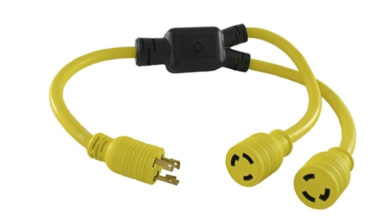

Define "splitter"
Shore power splitter.JPG (28.76 KiB) Viewed 9860 times
jfgkahaluu@gmail.com
Posts: 16
Joined: Wed May 26, 2021 5:10 pm
Re: 10.8M International Shore Power Question
Post by jfgkahaluu@gmail.com »
30amp split to 2 30amps.
