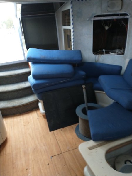

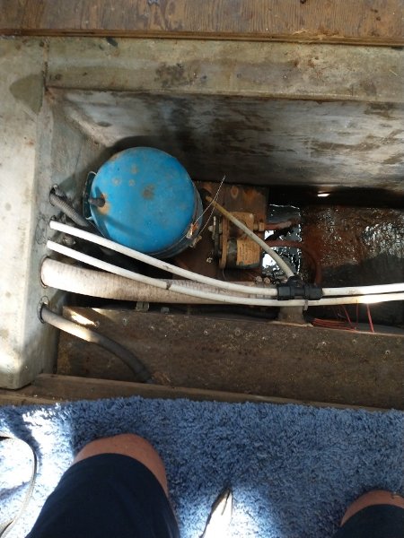

Hello,
I post this question to anyone who knows the location of the freshwater pump in a 13 Meter Express. This is the pump for the sinks, head, shower, not the AC pump. Thought it would be in the bilge compartment in the galley but it's not (maybe it's missing). Nor is it in the main cabin compartment, that has the waste pump and it's not in the second staterooms bilge compartment, that is holding the AC pump. I haven't been able to search the engine compartment yet but I figured I'd post this to see if someone might have knowledge of where it should be.
Thanks,
Lumpy

I found two water lines capped off in a compartment under the bunk in the. 2nd stateroom but no wirers present, my search continues.

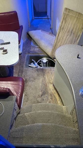

Hi
The fresh water pump is located in the first hatch as you enter the cabin
It is not the hatch where the waste tank and vacuflush pump is, that is the 2nd hatch

Re: 13 Meter Fresh water Pump location
Here

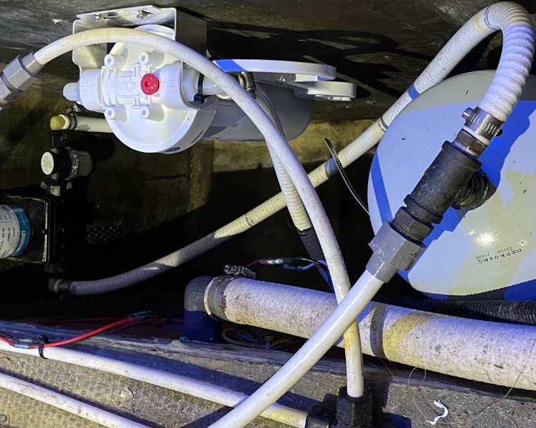

The other pic is not that good
Here is a better pic for location
Make sure you add a simple water filter after the tank and BEFORE your pump, I had issues for a long time with small pebbles/calcium deposits clogging my faucets
Also my original pump was mounted very low in the bilge, after failing I moved it up about a foot, it is easier to service and will never have a chance of getting wet if you have water in the bilge

You're right about the side stateroom and the AC pump location but the two lines I'm talking about are in the bottom berth hatch near the stern. That's where the two water lines are capped. Is this where you were talking about, plus I'm not familiar with a heat pump. Are you referring to the AC/ heating unit underneath the side stateroom storage locker? Hope all that made sense.

Here's the pic of the laminate floor that covers the hatch. No possible way to service anything in that hatch without ripping up the entire flooring, which I plan to do.

Rip the floor up and voila, there was the freshwater pump. My title saga still continues, now in the 8th month.
