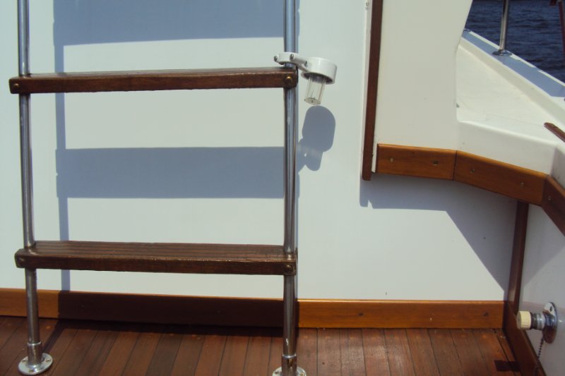

Re: New Tricabin Owner
Yep heres the back! Needs a little love on the teak and all.prowlersfish wrote: ↑Sun Feb 05, 2023 5:56 pm Any outside photos? Looks like the back wall was repaired at some point. I am not sure but thinking it was plywood. as far as the hours difference the can be several causes. Bad hour meter or its wiring? Engine or trans was inop for along time or broke down a lot. As far as what the go for? Seen them given away and some go for 20k+ Not enough info to even guess on yours way too many unknowns. Area engine condition are all factors.
The Aft wall was plywood and made to be removable. You do have the aft engine correct? Later models had the engines under the salon floor. Aft decks were known to leak many owners fiber glass the aft decks to fix the leaks many are rotted.

I would do something about your Power cords in the water.
Yep aft engines.prowlersfish wrote: ↑Mon Feb 06, 2023 8:40 am The Aft wall was plywood and made to be removable. You do have the aft engine correct? Later models had the engines under the salon floor. Aft decks were known to leak many owners fiber glass the aft decks to fix the leaks many are rotted.
Do you have the model number? Its located on plate on or by the electrical panel
The deck is already glass it seems. Just that back wall leak.
I do have a metal plate there with hull number and engine serials but no model.
The sheer volume of water that pours down each side and streams over onto the sole decking will pool up and flood directly into the starboard corner you are looking at in this photo (ditto for the port side). Fibreglassing the floor and/or replacing the back wall will not halt this flooding. You must waterproof the area directly behind the corner that you are looking at in the photo. The sole floor continues sideways right out to the hull ( some ten inches) and it also continues forward directly into the aft bedroom (it becomes the shelves present on each side) The vertical 10" X 10" partitions in each corner are all there is separating the back bedroom from the outside and will need to be waterproofed from the outside.

Thanks for the info on water proofing. Going to look into that this weekend. Looks like I *may* have sealed it for now.
That corner had a leak in it I was able to seal and also a leak coming from the box that was built up at the helm station area.
