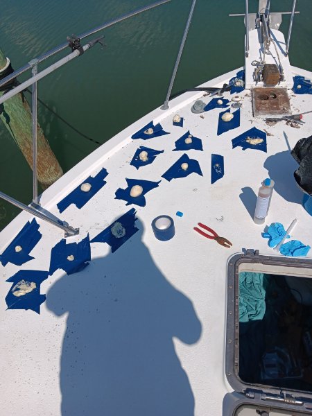

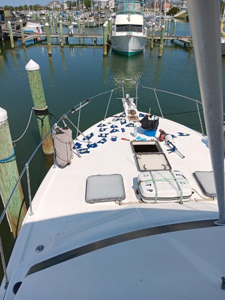

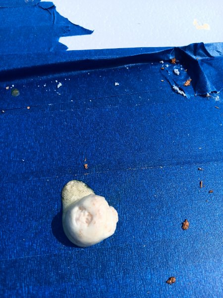

Like many other older boats I found my Trojan suffering from soft bow disease. Did not look forward to cutting the top glass open, So I looked at different options. Living with it? Paying someone? After much research, I decided on "Injectadeck". Reviews were mixed, but found the negative ones never used the actual product. Also spoke with several users (2 on here) They were positive. I expect some negative comments, but let me be clear about what Injectadeck is and is not. Injectadeck is a 2 part structural expanding foam water helps in the cure. It is a closed-cell foam. It flows and expands in voids and displaces mussy balsa. What it is not. It is not an epoxy or an open cell foam like great stuff or other 1 part foams and it's not Gorella glue.(but has some similarities). I drilled the holes to 3/16 and after filling very hard to see. Deck feels good now, would I use it again? Yes

Thank you. I am pretty pleased with it so far. Cutting it open is the best way, but it's a lot more work and you need days of good weather. This is pretty easy and goes pretty quickly. And I have heard from others it's holding up well over time. For this old guy, it was the right choice

What did you finish off the deck with after you sanded down the foam? And aslo I assume that product doesnt conitnue to exband?

Being a 2 parts the foam expands and cures quickly. I clean out the 3/16 hole and fill it with epoxy.

Thanks for the info and answers on this product. I may try it on the future. I just dont want to run into any lumps from the application as it expands and moves.

There is a danger of that so you need to keep a lookout, you can deal with it as in cures. Honestly, I think I can feel a very slight lump in one area, can't see it. And never felt for any before.
