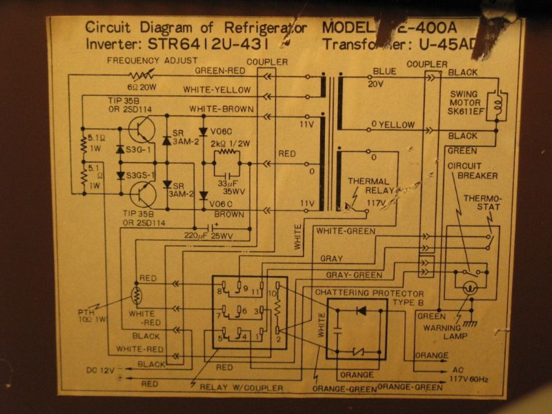

Here is the wiring diagram from a '79 DE-400A. Black to negative, red to positive. But if you have white (?), maybe you can follow the wires and compare to the diagram to figure out which is which.
Sorry the pic is so big, but at least more readable this way.
I may have more info somewhere else around here (on paper) and will pass along anything useful I find. My fridge crapped out a couple of year back and I ended up scabbing the electrical guts of a different unit into mine. If I remember right, the 'donor' fridge had slightly different wiring than mine.

WOW! I just found the papers from the rewiring I did (only half way down in one of my TO DO piles). Unfortunately, everything I have also shows red to positive, black to negative.
Good luck tracking down the white!
