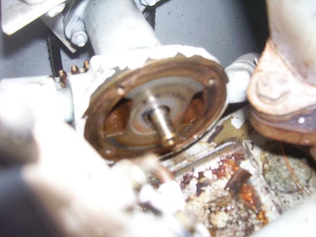

Couldn't get the Onan to pump though. Opened up the water pump housing and found the answer. The impeller was so worn it was not only swollen and had taken a hard set, but had spun free the bearing from the hub, and the input shaft was just spinning the bearing inside the hub. No worries though. Impeller and gasket kit on the way. I'll just have to live off the inverter if I decide to go out in the next few days.

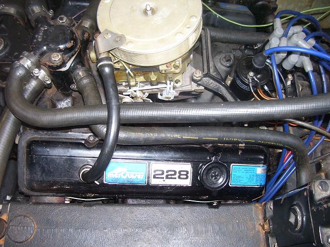

Heres the proper color factory power. This is the Stbd. The one that has a long time documented history of issues. Basically whats wrong with it is that its a 305 Chevvy with flat tappets, a Rochester and old skewl ignition. If ya give it 'The Fonz' it generally runs good. (i.e. kick it and it purrs ;) )
Stbd. Spring '13.jpg (126.31 KiB) Viewed 4996 times
Then ya have the ornery old Spec J Onan. This thing was hitting the sales floor when I was in 5th grade. Pump and spindle still in good shape though.
