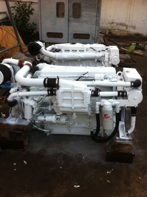

Hi!!! Am not too far from Dubai,its only an hour and fifty minutes by air. I travel there frequently. Getting oil from USA is not economically viable unless I import a container load.I get stuff from west marine (non-hazadrous) all the time but that is all in small quantities. Here is a picture of my re-manufactured 6-71TIs.

mmmm. yummy. I love 671's
