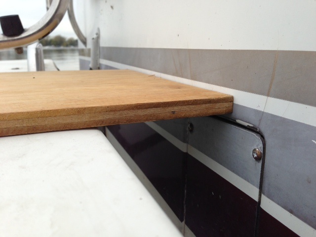

Ok Todd, here you go.
27 1/2" from top of platform to top of rail.
36 7/8" from water line to top of rail.
The top of the platform lines up even with the top edge of the rudder cover.
Let me know if you need other dimensions.
Mike

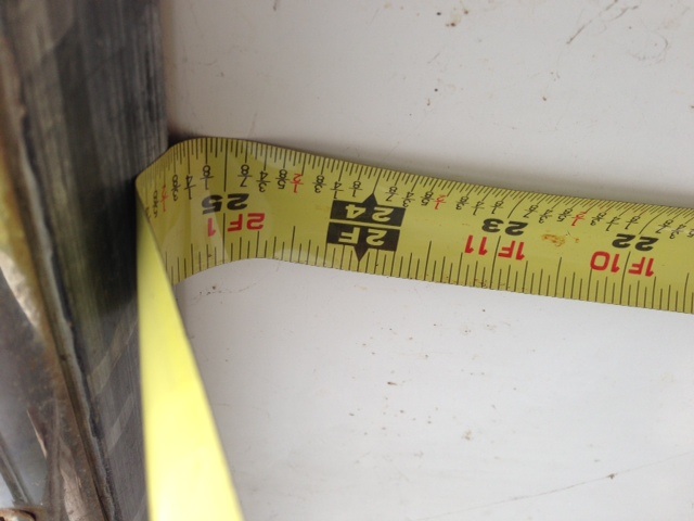

One more....approx. 25 3/8" from top of platform to bottom of rub rail.
I took a picture seeing that the rail angles a little downward.
