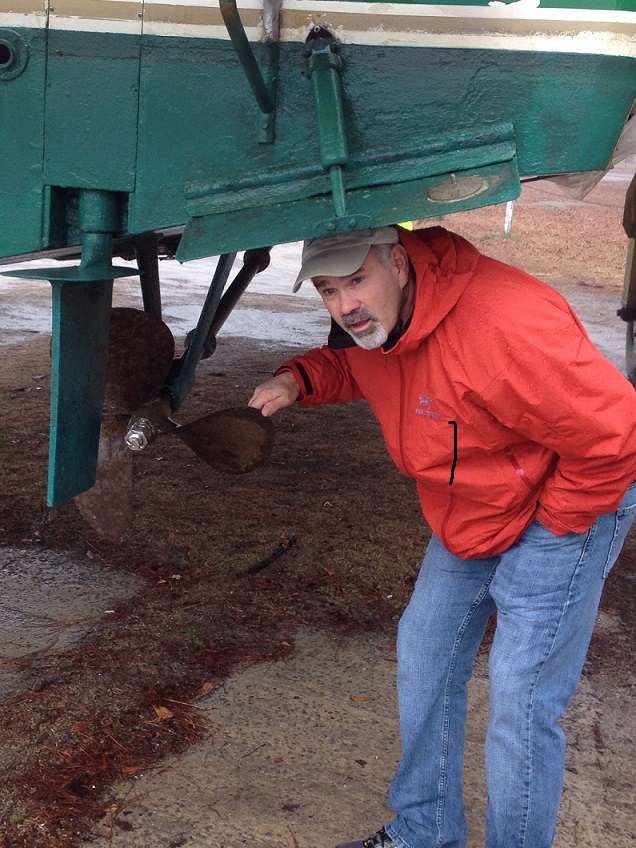

Not sure if I am seeing things right in the pictures... it looks to me like the tabs are mounted up an inch or two from the hull bottom. Am I seeing that right? The hinge should be essentially flush with the hull bottom to get maximum benefit when the tabs are down.

captainmaniac wrote:Not sure if I am seeing things right in the pictures... it looks to me like the tabs are mounted up an inch or two from the hull bottom. Am I seeing that right? The hinge should be essentially flush with the hull bottom to get maximum benefit when the tabs are down.
Hard to tell but that would be worth looking at for sure

FWIW my tabs are mounted flush with the bottom of the hull. My props are 24X27 four blade. I have to go to 3400 rpm to get the 17 knots that bocadakota has at 3200 and my fuel burn there is 34-35 gph. I'm sure the flybridge adds substantial weight compared to the Express model so not sure how relevant my numbers are to this thread.

Yes, it sure looks like they're too high. In fact, I think the mounting pads on the tabs are upside down, which makes them about 2" too high. If o, they could be removed and the mounting surface flipped up instead of down and remounted (may have to swap port/stbd tabs to get hole alignment?) they should be flush with the bottom of the hull and perform much better:captainmaniac wrote:Not sure if I am seeing things right in the pictures... it looks to me like the tabs are mounted up an inch or two from the hull bottom. Am I seeing that right? The hinge should be essentially flush with the hull bottom to get maximum benefit when the tabs are down.

that's a really good shot of the props.
I wonder if this is a situation of incorrect props and improperly mounted tabs?
Easily fixable, especially as compared to a wet cored hull.
As Roger Devore mentioned above, I am curious as to why with those big diesels she isn't wearing 4 blade props.

RWS wrote:that's a really good shot of the props.
As far as the Props Most likely it came with 3 bladed props for 2 reasons , Cost and speed . while 4 blades can have benefits 3 blades normally have a edge on speed . Mine boat is much better with 3 blades . But the last thing I need is more lift . Where as this boat needs more lift

In my opinion and compared to my 84 ten meter, your tabs are not properly installed. They should be flush with the bottom of the boat. Also the condition of your bottom paint and hull smoothness is not too good! Judging from the pictures, some performance is definitely being lost due to its rough, uneven condition. My bottom paint was very similar to that the first year that i owned my boat. The first project done before the next season launch was reconditioning of the bottom surfaces< new (ablative) bottom paint and what a difference! The build-up and roughness of all that surface against the water causes a lot drag. I never thought so but since scraping and removing years of build-up i am a believer>> the smoother the better! Either way, nice ride!

From what I see in the pics, the tabs don't seem to be in the right position but IMO, they shouldn't even be in the equation in this application. It's not like it would make or break this performance issue, and RWS confirms such with a historic trial. Something's not right, and I think you need someone who really understands the dyinamics of this hull, the make/model, running gear, and power plants to compile everything and make an educated determination of what may be going on. Confirm the props that should be on there from the OEM for those power plants; Beacon? A reputable prop/running gear machine shop that has been around for a while may also be able to help simply from experience and may have specs that work for this app. I have often found this helpful in the past.

The tabs really do look high. I will need to check that in person this weekend. The rudders do stick out off the back of the transom a bit but I can't imagine there would be any issues with them being lower.

One thing I noticed is the rudders are straight out. Don't they have to be 1.5 degrees in. Now just figure out how to do that and let me know. Or does it really make a difference? Oh, I have a picture showing where a larger piece of metal has been added to our trim tabs.
