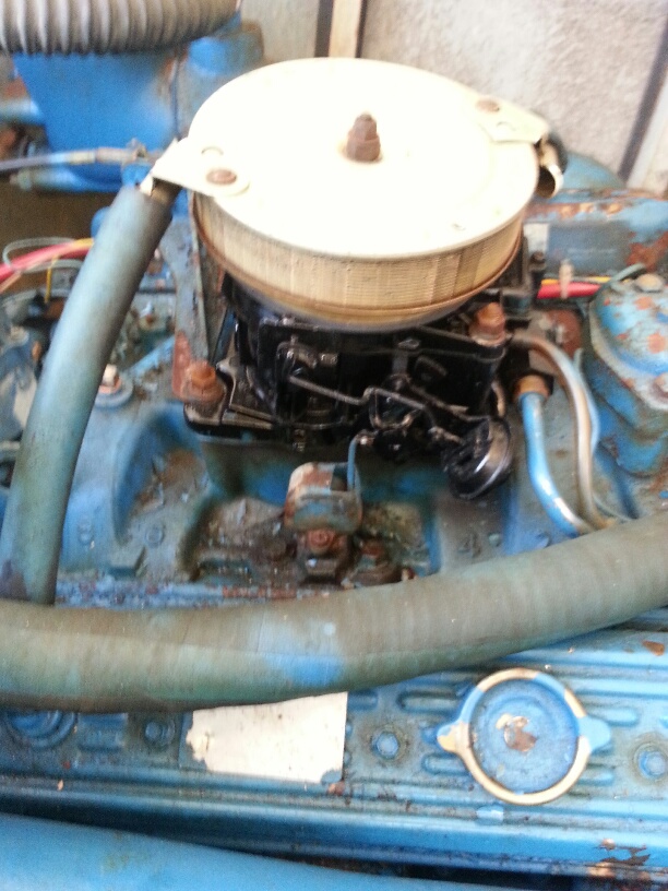

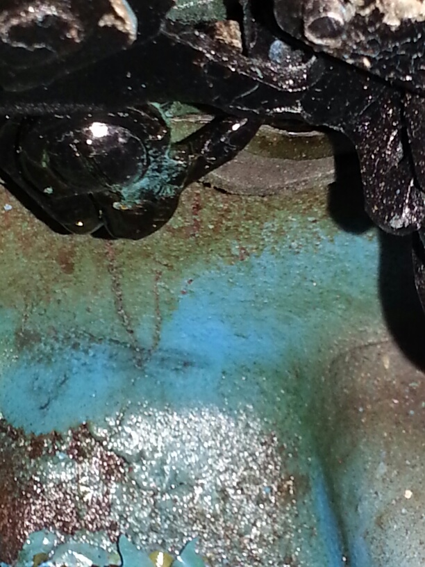

I am extraordinarily unhappy, but thankful be alive. I believe I have a crack in my intake manifold port engine, 2 inches below the carburetor, dead center of the manifold. When I was testing my alternator, I just happened to see this seconds after turning the engine off. You can kinda see bubbles in the close picture below; when I first arrived, gas was visible on the outside of the crack and puddled on top of the manifold for a few seconds until it evaporated.
Here is the top view of the manifold, look slightly lower than the flame arrestor and to the right
Here is a close in view
I realize this looks really obvious now, but look at the condition of my paint. I didn't see the crack because I've been looking at so many other problems and the paint flakes everywhere, I just didn't notice the 3" crack in the damn manifold. I'm very discouraged.

Changing out an intake on a 350 chev is easy,and it is hard to believe that a used intake for that engine could be more than 50 bucks------that being said you have to make sure that is really a crack and not the fuel running down from the carb gasket----clean up that area and watch closely-----one more thing, talk to a local engine machine shop as they may be able to stitch the crack for you---never seen an intake crack like that though-----good luck with it---Mike

The choke pull off is a thermal one and has a passage coming up to provide heat,there is really no gas runners there to provide the fuel to the crack to bubble,the spot gets very hot so any spilled fuel would boil and appear to bubble.
I would second the carburetor leak if you pull it off and clean the base you can lay it on a piece of glass to make sure it is not warped,sometimes the heat of a hot engine will cause the fuel to boil or peculate in the carburetor that has no spacer under it ,it may be doing that.The pictures may be playing tricks but where the back carb mounting bolt is looks cracked,to me anyways.
Like already posted the intakes are cheap there are tons of chev 350 ones laying around,that one looks like a very early 70s or late 60s as they switched to electrical choke pull off mid to late 70s,the difference would be if you do remove the intake,between automotive and marine would be or could be brass inserts on the water jackets,if not the early vintage intakes are beefy,you should be able to convert to the updated choke pull off and use a block off plate for the thermal one if it is giving problems.

In your first picture attached to the manifold,center of carburetor is the blue painted round thing or thermal choke pull off.
How it works is there is a coiled spring that when the engine is cold expands pushing the small blue rod up closing the flap in the carburetor,also called a butterfly,when that flap is closed it forces the engine to draw more fuel then air which is needed on a cold start.I may have the whole expansion contraction thing backwards but you can get the jist of the concept.
As the engine heats up the heat causes the spring to contract,while it does it pulls the rod down slowly to open the flap and allows more air to enter the engine,if it does not open you will see black smoke coming out of the exhaust,known as a sticking choke.
There is a runner or passage inside the intake manifold that carries exhaust and gets very hot,your engine gets to its hottest temp when you first shut it off because all cooling actions have stopped,oil and water circulation.If you have an internal leak in the carb when you first shut down it will suck raw gas in and sit on the top of the inside intake manifold and boil and vaporize or even boil out of around the gasket.You will smell it strong.
Also in the picture the runners that have the 2 4 6 8 firing order feed the fuel air mixture to the valves,the only way you can have fuel boiling out of the crack is if the carburetor is dumping massive amounts of fuel down the exhaust ports.If it was a crack you would hear it as an exhaust leak on start up then it would seal as it warmed up,expansion and contraction.
When the engine is running and hot you would be able to boil water on that spot where the choke pull off is.
What causes the carb to overflow? Inside are floats that control a needle where the fuel lines come in.Take the back off of a household toilet,flush it and watch it fill up,same concept,as the level of gas in the bowl is consumed the floats drop and open the needle allowing more fuel to enter,when the bowl is full the floats rise pushing the needle up shutting off the fuel.
If the little rubber tip on the needle is bad,or the floats are bad or out of adjustment it will allow the pressure or even suck up the fuel in the lines after shut down.If the floats are bad they will adsorb fuel and become to heavy to float and stop the flow of fuel.
So,easy way to check is to bring the engine up to temp,remove the breather after shut down and with a flashlight look down inside the carburetor and see if it is dumping fuel,if you see any at all then you now know why and the fix.They may have rebuilt the carb but not replaced the floats or they are sticking.
To check if the carb is warped or has a bad gasket,while the engine is running spray carburetor cleaner with the supplied little tube placed close to the base,spray around the entire base in little spurts and listen to the engine speed,if it increases then you either have a bad gasket or warped carburetor.
This may or may not be the problem but just another diagnostic step to find it,it does not matter if the manifold is cracked at this point you need to find out the gas aspect first which could also be your smell problem among what others have posted.
