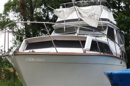

Just joined the group because I am looking at picking up a 30FT Trojan.
I currently own a wooden ChrisCraft that sadly hit by a tornado.
We pulled it out to repair the swim platform and found major hull issues, very sad day yesterday.
It is a bit beyond saving however I have found a Trojan that i can save.
I believe it to be a 74 or 74 30ft it has twin Ford 225 hp Mercruisers it has a flybridge. Can anyone tell me what model it is?
I here there is potential issues of the upper structure collapsing through the deck. What signs can I look for that this may happen?
I will be doing a full inspection on Sunday, and I know ChrisCrafts inside and out but Trojans are new to me.

- trojan.png (243.27 KiB) Viewed 9843 times

Jeremy72 wrote:Hi Guys
It be looks to a F 30 SEA RAIDER , Glass hull wood top sides . Have not heard of issues of the upper structure collapsing through the deck , But look for wood rot of the structure like you would on any boat .

To more directly answer your questions... The main cabin supports are heavy, the deck sheathing is thinner teak ply, but non supporting.
Water damage will show up where the deck meets the cabin, where the combing meets the deck, and some have had to replace the engine support stringers. These are fairly easy to replace in this model due to wide open, easy engine access. Take an ice pick and probe where a horizontal wood meets vertical structures.
The fiberglass hulls are thick and heavy, with ample gelcoat which allows many polishings.
Sitting out for years in the weather is hard on the wooden decks. Check where water would pool up and stand with an ice pick. Some damage isn't a deal killer if you can fix it on your own. Good luck!

Also, the swim platform under support struts are teak and abrade heavily from the prop wash. Don't be too alarmed at their narrowing, but a good point for price dropping.

To eval foredeck, lie on fore berth to visualize the teak cross supports. Try probing the corners and ply junctions where water would stand above. A soft deck could mainly be weak plywood, which is pretty easy to replace. If the curved teak cross supports are rotted, that's a big job to fix.

Also, where the windshield corner arises from the cabin top is susceptible to rot, but mainly limiting to the quarter round wood trim piece that forms the corner, I've fixed mine with white epoxy putty. However, if the main, flat wood windshield risers are rotted, they'd need replacement since they support the fly bridge.
The long cabin top and cockpit side cowlings are shaped plywood with vinyl stretched over. Like the ply teak deck covering, this is not tough to replace with new plywood and you could use epoxy coating and glassing in lieu of the vinyl. My vinyl is pretty good with many repair spots of some kind of white sealer, so an area of vinyl damage does not necessitate total replacement.
In addition, the wooden spray guards down by the waterline, attached to the fiberglass hull can rot and bumps can separate the SS trim band from these as well as the swim deck. White epoxy putty and toothpicks into the loose screw holes easily repaired this. Black epoxy or black wood filler repaired the SS trim gaps on the swim platform. When those areas hit the dock, it springs the metal trim away, leaving a huge gap which is mainly due to the trauma, minimally due to rot.

Great info guys. I will be doing a ful inspection today and I hope it is all solid.

The bulk head behind the helm is rotten and the corners of the hardtop/flybridge floor are soft. Plus where the side meet the deck at the rear of the cabin have have a rotten piece about a 6 inch square piece. All looks fairly easy to fix With some plywood and A few mahogany pieces. The front deck are all very solid surprisingly enough.
Looks like I will be saving this boat from the wreckers.
