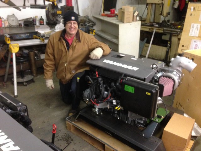

Two big Yanmar boxes arrived on Christmas Eve. I don' think I've been so excited since I was probably 13.
Yanmar 6BY3-260's
Yanmar 6BY3-260's
Re: DIESEL OPTIONS FOR F32?
Unwrap the enginges and take pictures !!
Yea, if there are no pictures, it didn't happen!

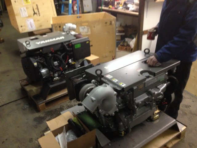

One engine is already in Whittier and the other one is still in the back of my truck, all bundled up and headed for Whittier in the morning. Photo ops are sure to ensue.
I know what you mean about the 'feeling' of diesels. I get it every time I get on a diesel boat. It was a major factor in converting over.
Very, very nice David
I've studied the specs from the Yanmar Homepage. Bit I did'nt found anything
about counter-clockwise rotation for the second portside engine ???
Did you get this ?
I also think that you'll need bigger Props - that's right ?
Greetings - Heiner
On those and most diesels ( anything recent ) the direction is controlled by the transmissions . In fact that's true with a lot of the newer gas engines .
