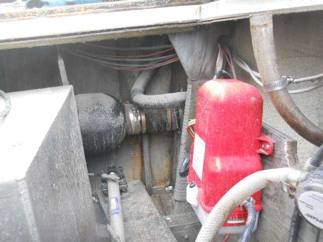

Re: Original Mufflers in F32
Mine are either plasic or fiberglass. Just looking at them I'm thinking plastic. Attached is an old picture that shows the end of one.
I would guess glass . Look close at it if its glass then you maybe able to see the fibers . http://www.centekindustries.com/vernatoneround.html
I've seen one of these blow due to a backfire. Appeared to be fiberglass. Nothing much to them at all.
Can't speak for anybody else but every muffler with a blown baffle that I've come across has been pretty obvious because of the rattle the loose baffle makes banging around inside while the engine is running. If the port size is enough for the repower spec, and the units are glass not metal, I'd leave them unless you have reason to suspect there is an internal problem.
