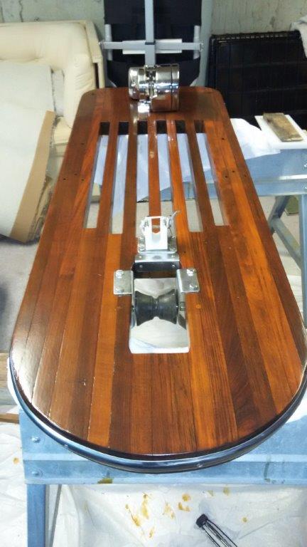

OK, It's done. I am going to reinstall it with the new windlass in a couple of weeks. That teak sands like granite! I sanded, sanded and sanded. I have about 7 coats of Cetol natural teak finish on it. I am pleased with the results. I just hope it puts up with the abuse, but time will tell.
20160330_171525 small.jpg (91.97 KiB) Viewed 5450 times

Looks great! you wouldn't know that was the same pulpit.
The shiny stainless/polished hardware (windlass, edge band) really turns it up a level :)

You can't beat the finish and protection. Just plan on a light scuff and re-coat yearly! Great Job! 8) :)

My advice with the cetol is to make sure you give it a "fresh up" coat before the sun manages to break through the finish. I used to give my teak one coat every two years. I gave that small section at the bottom of the ladder to the swim platform a new coat yearly.
Great work, btw
