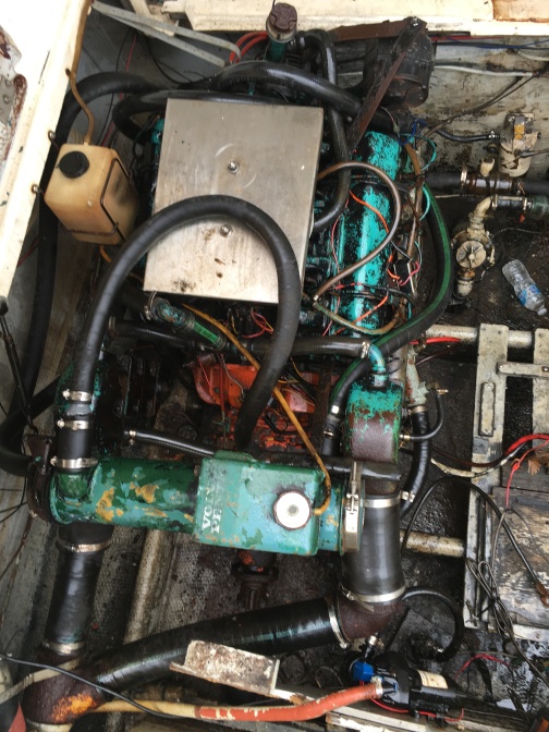

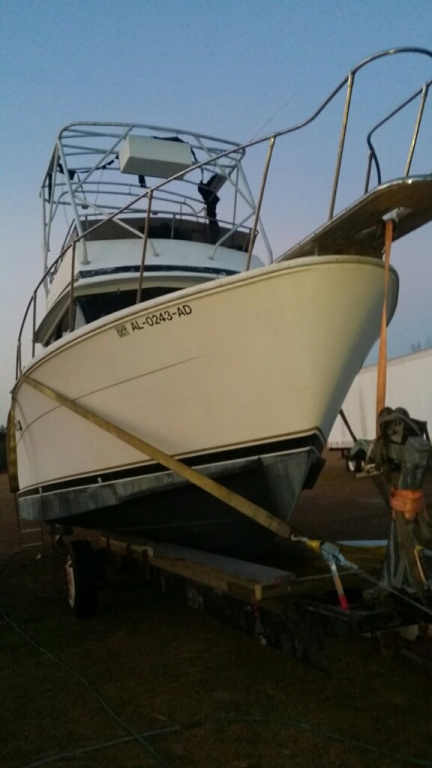

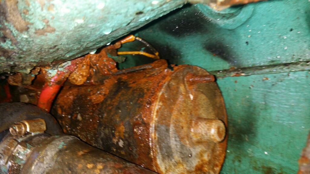

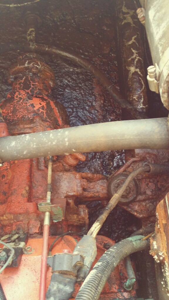

found out I was incorrectly informed about the engines. I had taken photos of the motors and showed them to a detroit mechanic. he stated they were 8.2L engines. we knew the starters were bad as the boat had fresh water in the bilge and they have been covered for some time and are very rusty. got a closer look at the motors while trying to remove the starters and found out these are not detroit's but GM 6.2 diesels. Got a lot of cleanup to do.

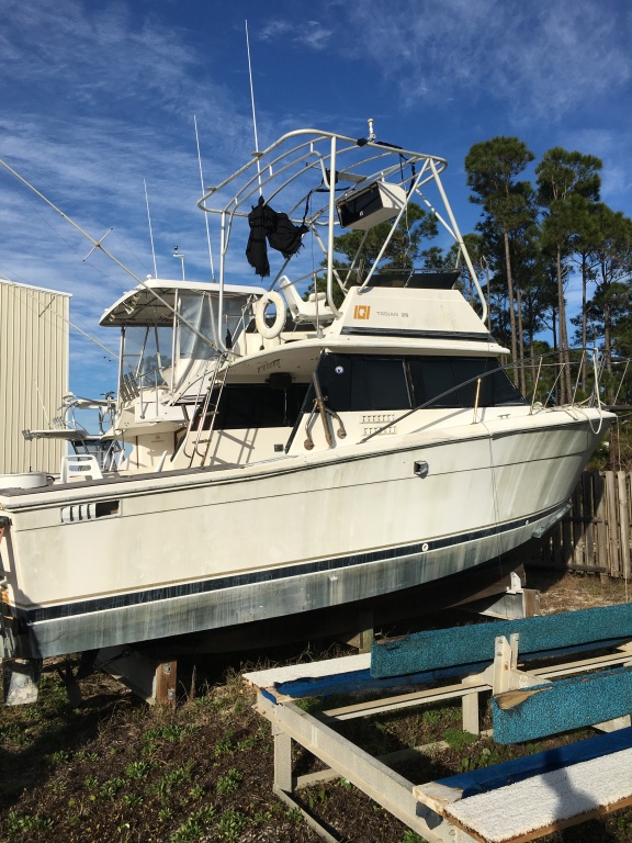

As I found her, and after a bit of power washing

While to do have some work to do , that is a good looking boat with nice lines . The model # 290 means the boat is a F29 Sportman . I agree the engines are not 8.2 liter DD and most likely 6.2 L could possibly be 6.5 as the are the same basic engine . They used the same parts that bolt on . Only difference would be noticed inside . I always liked the 6.2/6.5 .

Thankfully, I have a freind that will pull the boat out with the " trailer " we built from a semi truck frame so that cost is a non issue. I intend to pull her out in the winter time but that may change. Winters here are mild and most people leave a boat of this size in the water.

Going purely from what I can see in the picture, the tranny looks like it's been submerged for a while. Personally I don't know how comfortable I would feel with putting it back into service without assessing it first. Again, remember that all this hardware could be spinning at a few thousand rpm.

I agree with Big D it looks like the water did get well over the trans (and starters ) . All that needs to be looked at closely

I've seen worse :lol: :lol: :lol: :lol: :lol:
I really like the layout of those 290s, cool boat!
Looks like you have a couple projects to do, but you'll know exactly what you have when you're finished.

just a short update. pulled both starters out. one was shot ( the one pictured in one of the above posts ) and one we actually were able to save. it wasn't as badly corroded as the first one and it cleaned up rather better than I had hoped. Tore it down and inspected and cleaned all parts. put it back together and hooked it up to a battery and it works great. it appears that it was a newer starter and a high torque one. the other was a direct drive. found a place to get a replacement for the starboard starter and have that on order. one of the 1 1/4 hoses felt a bit soft so I'm going to replace it just to be on the safe side. still working on cleaning up the engine room but it does look 100% better than the above engine photos.
