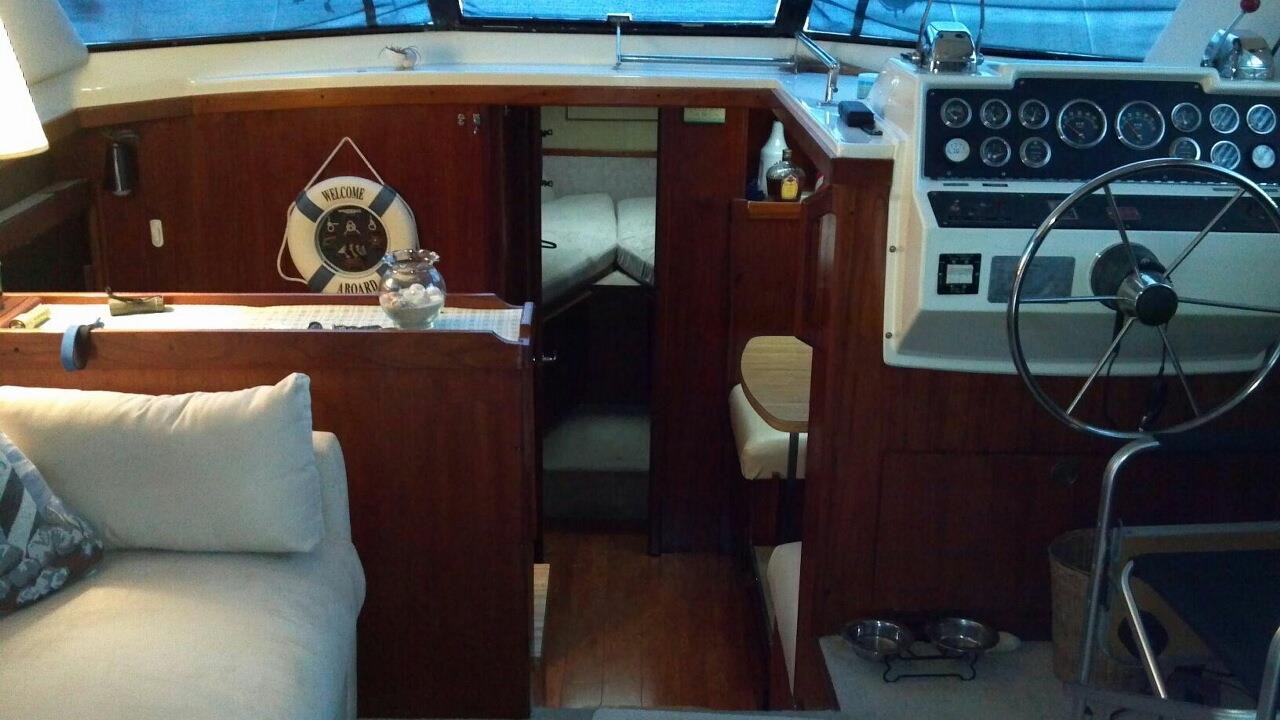

I found some old pics of the almost completed project
I trimmed the edges with teak and cleaned the black up with some tire shine stuff
http://s814.photobucket.com/user/CJMOUN ... t=3&page=1

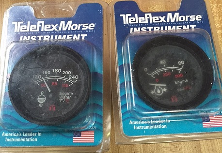

So, i haven't checked back on this thread for a while. I ended up getting a full set of Teleflex International Gauges. I installed 1 gauge, (took me about 2 hours). The combination of the lack of spare wiring, and having to change our the Butt connectors, made for a painful project. Debating getting a professional to finish the job. Need to make sure all Gauges are accurate! Thanks for the input!
