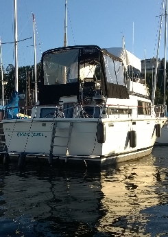

:shock: Some initial attempts to touch up the black stripe, a racoon-like mask around the rear stateroom of the trifly, have made me think about eliminating it. Initially it seems the stripe has been painted on? Can this be true? Or is it gelcoat?
Anyone know?

It is paint. I redid the stripes on my F32 a while back. The biggest challenges are degreasing / dewaxing first, working around hardware (that would be a bugger to remove), and all the damn spiders and other bugs that are attracted to new paint like a magnet!
I used Interlux Brightside Polyurethane. http://www.yachtpaint.com/usa/diy/produ ... thane.aspx
Good cleaning to dewax / degrease, light sanding to rough surface up and fair around any chips, wipe with solvent to get all the dust off, mask, and then used the 'roll and tip' technique.

Mine was prety far gone and the gell needed a wet-sand anyway. I eliminated mine and it looks a bit more updated.

Yup for sure painted on. I sanded mine right off. Then re did it kind of!
this is just sanded off to original gel

Hey Barrie, thanks. Yeah there are so many bad paint jobs that I might sand er right down. By the way, I recall this post, how are the patches you made holding up? Did u use reinforced fiber stuff? I need to do that too. Here is mine from the rear.
