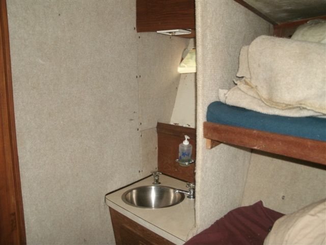

Like so many boats of any considerable age, my boat has sustained substantial mods over the years. In my case, the forward head was separated in 2 with 1 half modified into a locker and the second half extending to the V-berth with access to the sink. My plan is to refit the boat starting from the bow and working my way to the stern restoring the original layout. All of this while using the boat...

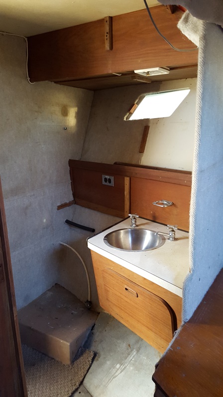

This was the original state of the V-berth when I acquired to boat.
As you can see, form the v-berth you had access to the sink. As far as the other half of the head, it was transformed into a locker.

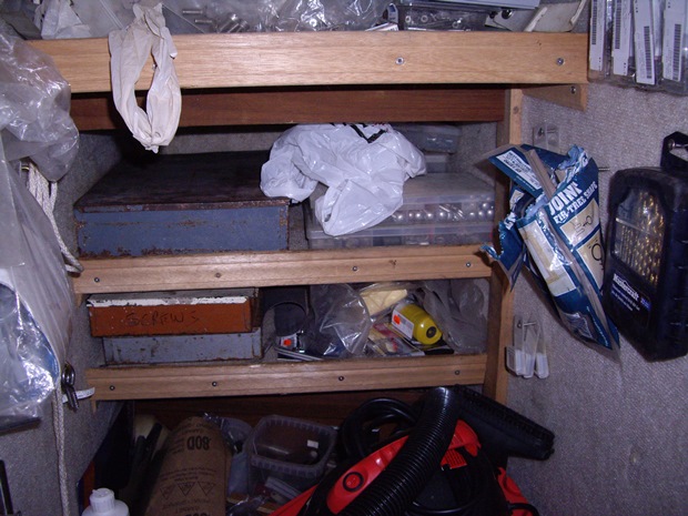

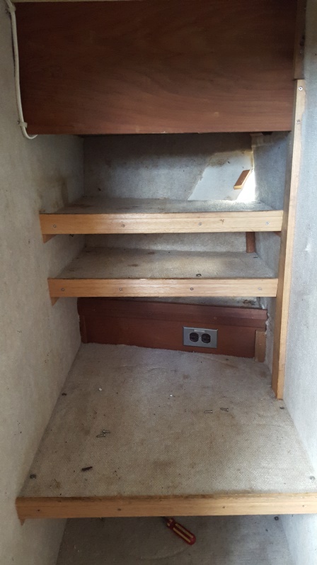

A few weeks ago, I started the re-model. I emptied the locker...
Removed the shelves and the additional wall.

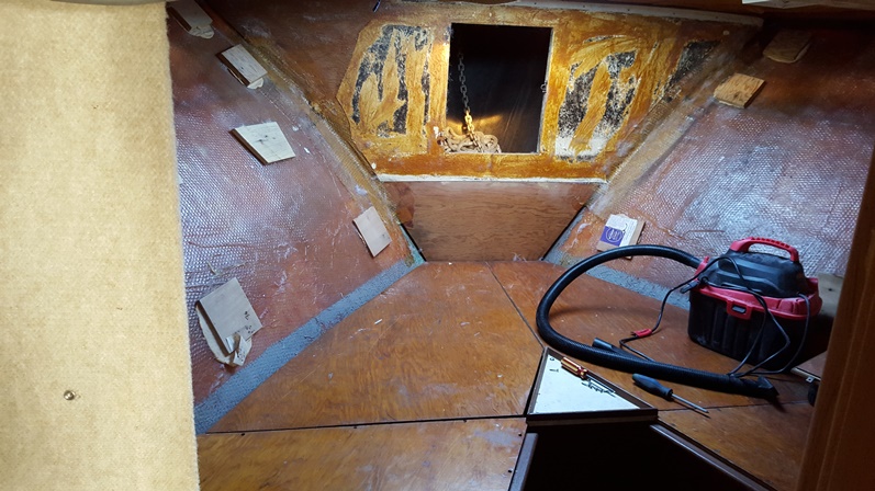

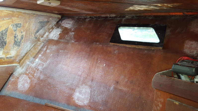

I then removed the headliner, the 10,000 staples and the wall covering...
Re: Show me your V-Berth
Removing the plywood pads on the walls and ceiling was a PITA. I had to use a wood chisel to get most of it off and finish with an 8" grinder and sanding disk...

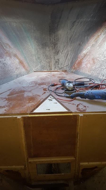

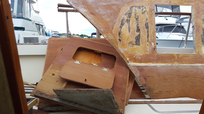

Today I continued stripping the V-Berth. I got rid of the chain locker bulkhead. parts are flying out of the boat now
I did leave the bed frame in place until now because I needed a platform to grind off the tabbing of the bulkhead. I guess now it's ready to come off!
This is the pile of stuff I took out to this point.
I have a few observations. What I found is household electrical wiring to the v-berth heater. (I half expected Knob-and-tube) LOL and the heater is not explosion (ignition) proof. Is this normal? I would have expected better from Trojan! Oh well. I'll have to fix this as well...

Good luck, looks good so far. People really butcher up their boats, then it takes someone like you to put it back to a proper state.
Where are you going to store your chain/rope for the anchor ? As far as the heater it would not be explosion (ignition) proof as its not in the engine room or fuel area .Christian wrote:I'm on "vacation" this week. So I can work on the boat. My sweet Better Half could not join me so I can make a mess as much as I want![]()
Today I continued stripping the V-Berth. I got rid of the chain locker bulkhead. parts are flying out of the boat now![]()

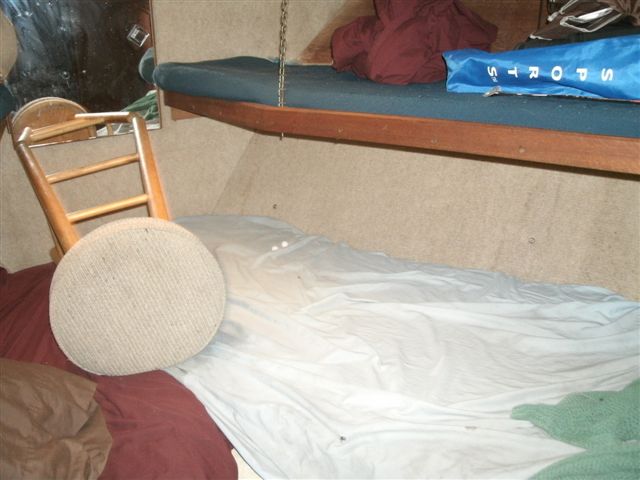

Misty wrote:Here is mine. All original.
- resized(2).jpg (12.96 KiB) Viewed 10820 times
