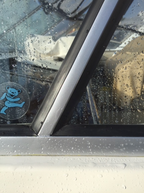

I finished up my entire windshield this weekend. I have some more painting to do in the process (zinc primer, silver metallic paint/clearcoat) of the frame while the trim was removed.

Here's a pic. Doesn't look like much but if you still have the original trim you know how bad it looks. This is a huge improvement from what I had. It takes a long time, I would avoid ripping it ALL out if you decide to tackle this project. I would do one, maybe two windows at a time max.
Harris, I'm going to re-do a few sections to get get better looking miters. Let me see how much I have left over and will drop you an email.

Luv the sticker Bob!
