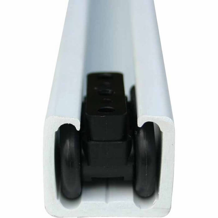

This is what mine looks like minis the L channel . I stole the pic from a post by Captain M ( Thank you Captain Maniac )
- f32 door track.jpg (53 KiB) Viewed 12357 times

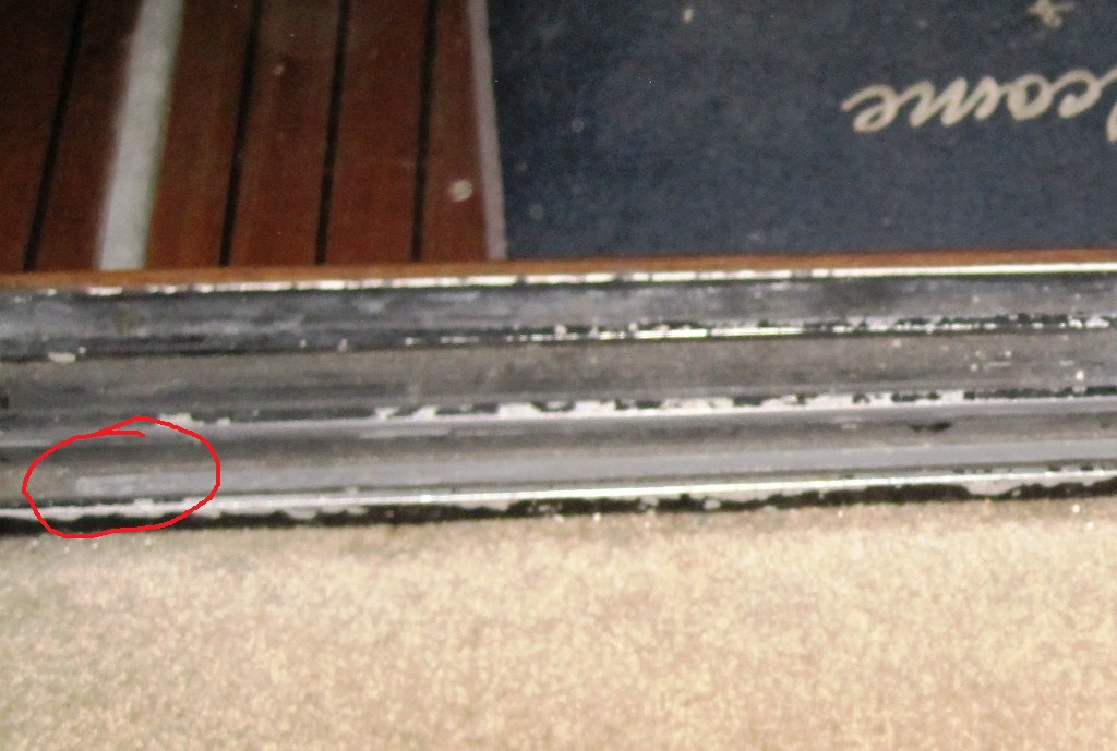

This is a terrible photo, but it is the only one I could find that shows the door tracks from our boat. The closest track is the one the sliding door rides in. If you look at the left side, you can see where the door roller stops when the door is closed. This side does show some wear, and I can see it in the photo if I squint a little, but the other side is where it is really bad with a lot more wear and chatter bumps.
I am really leaning towards taking a router and machining the track down until it is flat and then replacing the wheels with slightly larger ones like LandVF36 did. The thought of putting a more wear resistant strip of stainless steel on top is also intriguing, but I don't have access to a machine shop to size it correctly.
On a related note, has anyone painted or otherwise tried to repair the finish on the track? Any success with something that holds up?

Am I seeing that right - your slider runs on the inside of the fixed panels? On my F32 the slider is to the outside (aft side), and screen door is forward (where I think you are showing the marks from the roller circled in red). I would have thought he doors would have been made the same way on both models.WayWeGo wrote: This is a terrible photo, but it is the only one I could find that shows the door tracks from our boat. The closest track is the one the sliding door rides in.

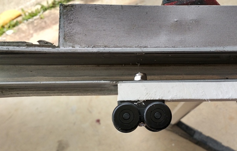

On my 12m, the tracks were a mess. I almost considered dumping the sliding door and going with a more modern sport fishing style hinged door, but it was cost prohibitive. I instead replaced the bottom of the door with a captured poly wheel setup from Boat Outfitters, and then screwed poly track down to the sill. The poly spacer block between the wheels and door edge adjusted the height. Works great.

Yes, the slider is on the inside, then the fixed panel, and the screen is on the outside.captainmaniac wrote:Am I seeing that right - your slider runs on the inside of the fixed panels? On my F32 the slider is to the outside (aft side), and screen door is forward (where I think you are showing the marks from the roller circled in red). I would have thought he doors would have been made the same way on both models.
It might be possible to switch the slider to the outside and the screen to the inside, but I would have to be at the boat to see if that is feasible. If it is, it would be a quick fix.

El L Sea, I am not sure about the orientation of your photos. Are the wheels vertical or horizontal when installed?
Re: F36 Convertible Sliding Door Track
The wheels screw into the bottom of the door, and the tracks screws where the old track was. So I guess you could say the orientation is the wheels roll along the deck. The picture of the door frame (1st pic) is from the side on my workbench. I actually just slid the bottom part of the door off the glass and everything so I didn't have to haul the whole door home. The bottom picture shows the actual orientation.WayWeGo wrote:El L Sea, I am not sure about the orientation of your photos. Are the wheels vertical or horizontal when installed?

The photo without the glass threw me off -- now I understand. How did you remove the existing track, or did you put the new track on top of it?El L Sea wrote:The picture of the door frame (1st pic) is from the side on my workbench. I actually just slid the bottom part of the door off the glass and everything so I didn't have to haul the whole door home. The bottom picture shows the actual orientation.
