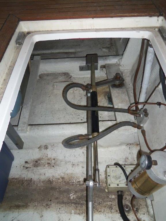

Here is a Photo of one set up This is from Harts boat similar to mine But a lot less rust and a lot cleaner too. I will post mine later

Yep, that's pretty close to how mine looks as well.

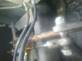

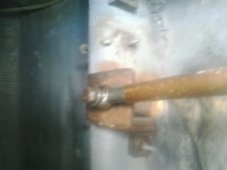

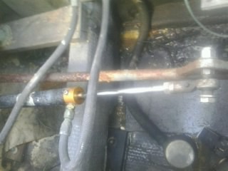

MIne , Done with a phone :| Similar to Harts but different joints and some extra rust

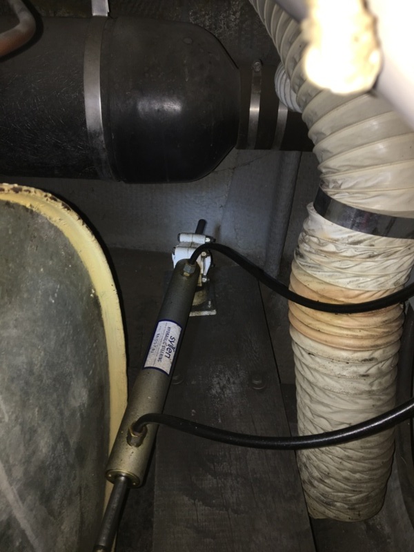

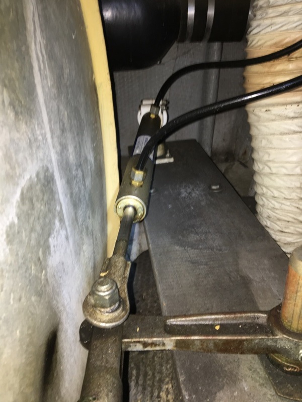

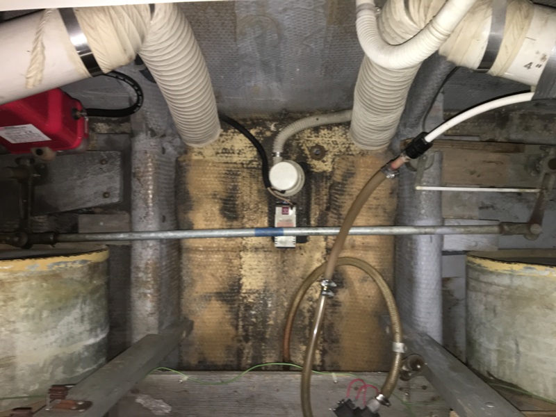

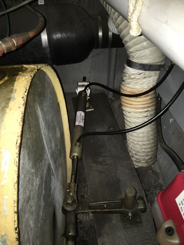

Got buggered up today and didn't make it down to the boat, so no good pics of installation of the NEW ram, but here are some shots of the old (Trojan original 1979 F32) setup... Hopefully have shots of the new one tomorrow night.
FYI - original Syten system had hoses from power steering hubs (pumps) to a 'uniflow valve', then two lines from the uniflow valve to the ram. Original setup on F36 and Tri Cabins differed... Current Telelflex SeaStar systems (as sold/marketed) have lines going direct to the RAM, but in my current config the uniflow valve is still there as it was reused by 'my guy' so I didn't have to replace all hydraulic lines with new lines of different diameter.

This is all quite helpful! It is interesting to see the differences between the F36 and F32 in regards to the placement of the ram.

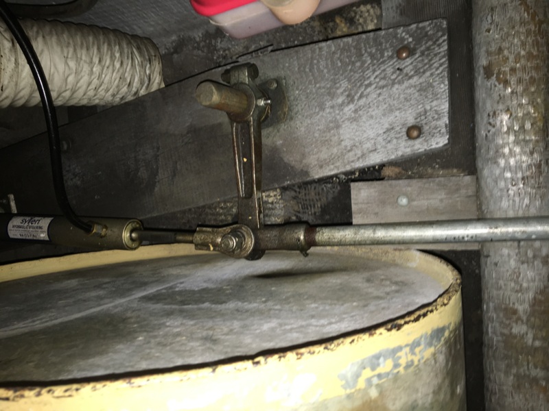

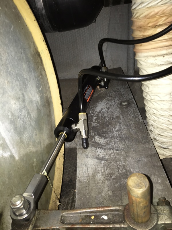

Finally have a shot of the new ram...
