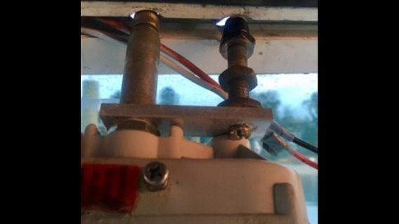

Do you have a photo of what you are looking at? We might be able to help more if you would post some.
tcollins2
Posts: 172
Location: Huntington, NY
Re: Vetus Wiper Motor Replacement
Post by tcollins2 »

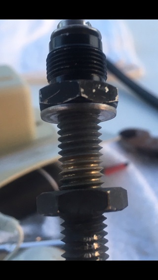

This is the piece I need to get out, I tried to unscrew it but the head snapped off.
If I can unscrew the dummy wiper arm from this, then I might be able to save it.
They give you a new one of these parts with the order of a brand new set up double wiper arms.

Upon a closer look, I didn't realize there was a part of this that spins, I thought that the whole thing was one piece.
