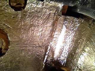

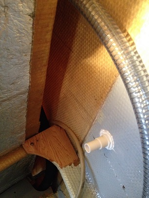

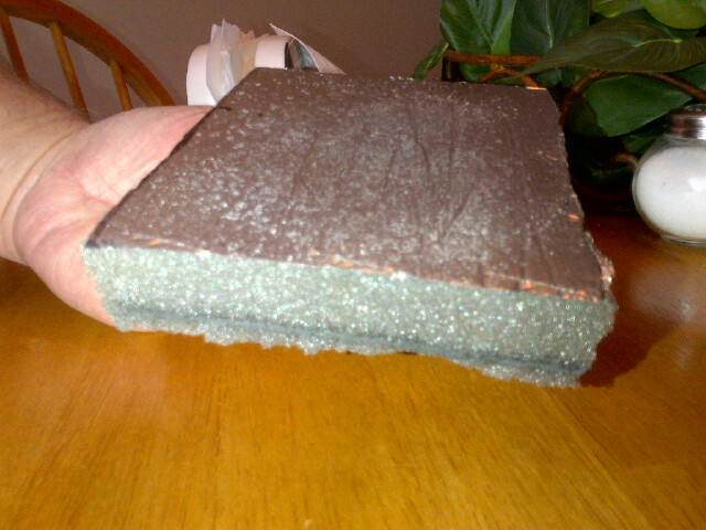

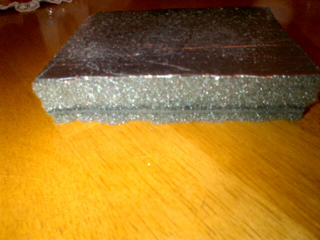

I started working on this exact problem a couple of years ago in the rear of the cockpit where it was easiest to access. The undersides of the cockpit floors already had some sound proofing done to them but I found that the open areas between the cockpit liner and the outer hull acted as an echo chamber which is made engine/generator noise worse. By blocking off these areas in the rear cockpit with soundproofing, it reduced the sound of the generator dramatically. This year I have the fresh water, black water and hot water tanks removed which gives me access to these areas in the forward cockpit for soundproofing.
Below is a picture of the area between the cockpit liner and the outer hull. Below is the picture of a piece of the material that I used. I don't recall the brand however it's about an inch thick and the back side is peal & stick. Below is a picture of the area blocked off with sound proofing as well as half way down the hull. I've also done the forward bulkhead in the engine bay to help keep noise down in the cabin when the generator is running. I'm fairly confident that my efforts will result in a quiet boat this upcoming season.

Hey Paul, thanks for the pics and info...
Does that product in the pic have any kind of integrated sound deadening rubber/ poly type layer?
Been reading a lot about the principles of sound proofing. Apparently the combination of foam and rubber layers are the key.

Re: Engine sound deadening....
Hi Paul,
Doesn't have a specific rubber layer, its made up of chopped foam and what seems possibly like neoprene rubber. I'll find out what the brand was and let you know. I can tell you that it comes in approximately 2' x 3' sheets and I think that I paid 30 something a sheet.

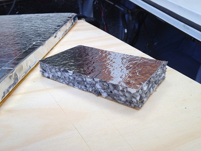

Here is what I used, can't remember the name though, comes in sheets or a roll and is heavy.This is fire rated and works for heat and sound.
