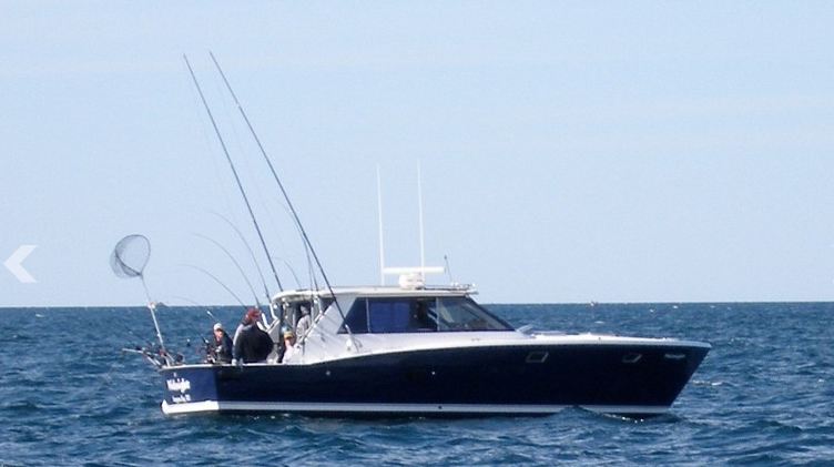

I would love to buy a ready to run boat that has what I’m building, but please find me a 36’ hardtop pilothouse yacht with lines as nice as the Trojan 36 with new or less than 5 year old engines and running gear on it. The closest things are a Sabre 42 salon express, a mainship pilot sedan 34, or a hinckley picnic boat 40. Now notice all those boats are 300k used. I attached a photo of F36 midnight. Look at that thing. I mean c’mon!

- 9B81FF98-A32F-4A5C-AD22-93FEF36085DE.jpeg (46.97 KiB) Viewed 7036 times
