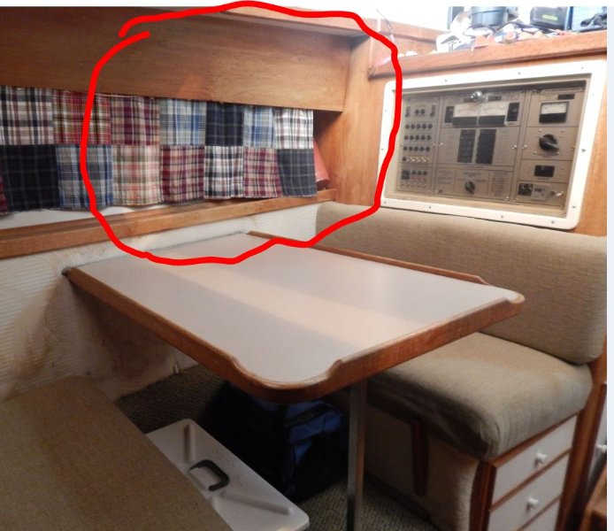

So after 18 years being under a covered slip, and now moored in an open slip, we've discovered a few water leaks where water is dripping from the bulkhead above side windows in the salon in our 1985 F32. We have small holes where previous owner had window blind hardware attached to it the fiberglass. Water is getting into cabin top and finding it's ways down through these small screw holes.
I have lifted the fly-bridge surround and caulked all screw holes and rebedded with new screws. I know others have had this issue and perhaps found the source. Rain gutter all around is clear and free of debris. I do have a half tower and am getting ready to uplift the surround and tower piping and inspecting again...
Any thoughts would be greatly appreciated.

Thanks for the reply. NO, my leaks are above the salon windows, port and starboard. Windshield is not leaking and I re-bed my seat bases a few years ago so I don't think it's coming from them. The console maybe...the side cover up on the bridge, possible and I will look into that as well.

Also, if you have water in the core of your flybridge, you will get water dripping when you drill holes for blinds above the salon windows. That is a low point in the coring.
I recently found out the previous owner of our boat had drilled 1/4" holes in the floor of the flybridge under the carpeting. I assume he just abandoned a drill and fill repair without sealing the holes. I will be repairing the coring the next time the boat is on the hard. Just one of many surprises we have found along the way. We keep making progress towards a safe and reliable boat!

Yup, there is water in the core and when it rains, it leaks from the holes which previous owner drilled for window blind hardware. I'm trying to see if anyone has had luck with finding water intrusion from another source then the obvious places which have been mentioned.
