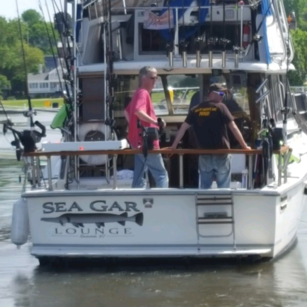

Has anyone ever made their ladder removable. Trying to figure out the hardware that might be needed. Also willing to hear all ideas. I want to build a filet table and jig locker in that dead space behind the ladder. But i need to be able to remove the ladder to clean fish.

Look up pictures of F30 flybridges. Ladder on many (most ? all ?) of them folded up onto the bridge when not required.

The ladder on my 1978 F30 folds up and sits on the bridge deck. That gives a lot more deck room down below and makes boarding much easier since it is not in the way. Folding process is very easy.

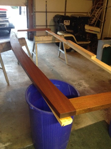

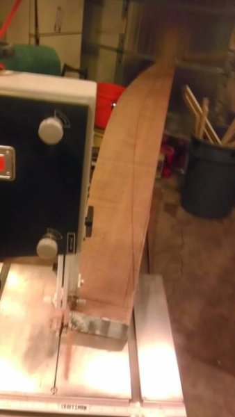

Paul - We completely scrapped the factory setup.
At times we are running 21 lines and get 3-5 people shuffling around the back deck ( double, triple, quad hookups). This one is made from 1.5" thick wall stainless and welded stainless flange. gap height is 17.5 inches.
The board was fashion from a 2" x 14" x 17' piece of Mahogany. ( I don't even want to admit what the piece of wood cost ) This allowed me to match the aft curve of the boat while having one continuous piece of wood. The p/s pieces were cut from the remnant and doweled, glued and mechanically fastened.
The whole setup is super strong and I don't worry about people as much with this setup.
Couple of pics of the build
