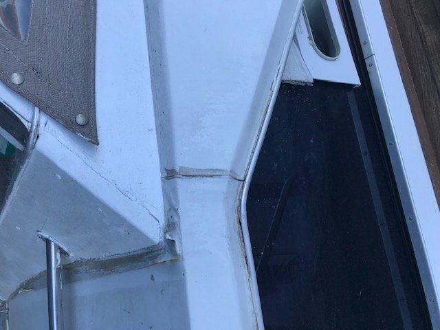

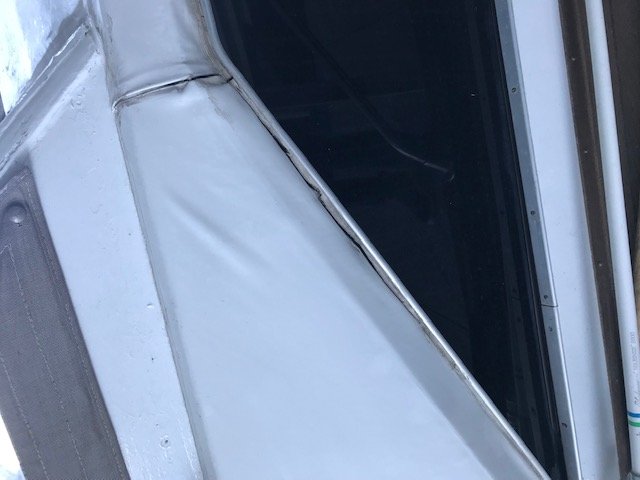

Hello everyone!
I am very appreciative of this forum as I am planning to purchase my first Trojan, a 1973 F26 Sea Raider! While the boat appears to be in very good condition, there are a couple trouble spots on the exterior of the aft cabin around the windows, as well as over the windows in the front cabin that appear to be 'pealing away?'
*PLEASE SEE ATTACHE PICTURES*
Can you tell me if these were former repair jobs, or simply areas that need fiberglass repair? The hull is fiberglass but its evident there are some wood features around the cockpit, just not sure these areas in the photos are fiberglass?
Any insight would be appreciated, thanks!

Re: 1973 Trojan Sea Raider - Exterior Seems/Cracks/Seals
I know the top side were wood not sure if they covered them and if so what with , Owens used canvas , Someone will know . Bob ?
The Sea Raiders were half breeds. Hull was fiberglass and the top was wood.
What salon top and hard top were covered in what is called “cabin top” Which is a white canvis/fabric which was glued to the wood.
From your pictures it looks like “cabin top” with 50 years of paint on it.
Let me check to see if we have any at the wearhouse.
Beacon Marine
609 713 4602
Beacon Marine
609 713 4602
