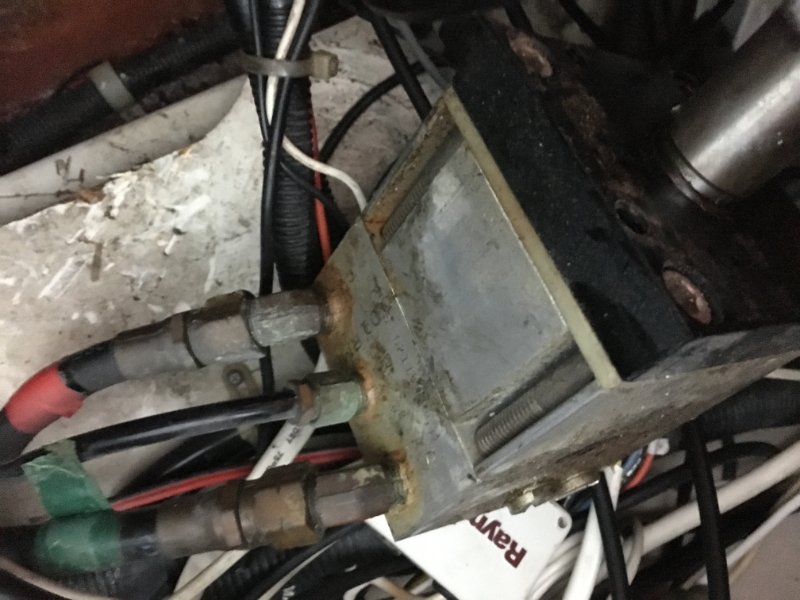

Just found out a seal in my Hynautic let go and there was steering fluid all over. The clean up took longer than the install of the seal kit.

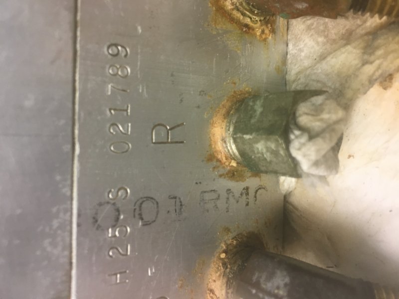

I had and H20 series Hynautic but I wasn't sure which one. I found out only by removing the steering pump and cleaning it up that the model number is on the unit. It's and H-25 S with a serial number after it. Don't know what the S is or what the serial number is but the seal kit is HS-02.
There is a youtube video for this model which was ok, it helped me figure out which way one of the o-rings goes. Took my time and it all worked out.

$39 for the seal kit.
Just need to bleed it. Does anyone know if you open the two brass hex nuts below the reservoir, does fluid drain from there at all? Not sure if I need a bucket under there or not.

Fluid may leal from them when lose but it does not come out per say . I put a oil absorbent towel under it .

There are usually bleeder fittings on the steering ram or just turn the wheel back and forth several times and it will bleed on its own.
