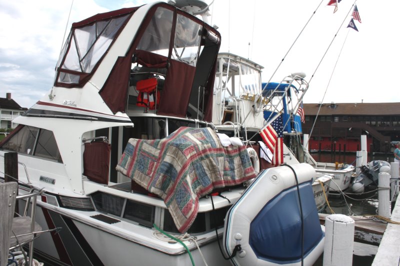

Here's a photo of an aft cabin model located at www.trojanboat.com:

They also made a Flybridge aft cabin . But I believe they were only made in the earlier 80s .
- Trojan trip ( wes photos) 120.jpg (90.92 KiB) Viewed 10120 times
