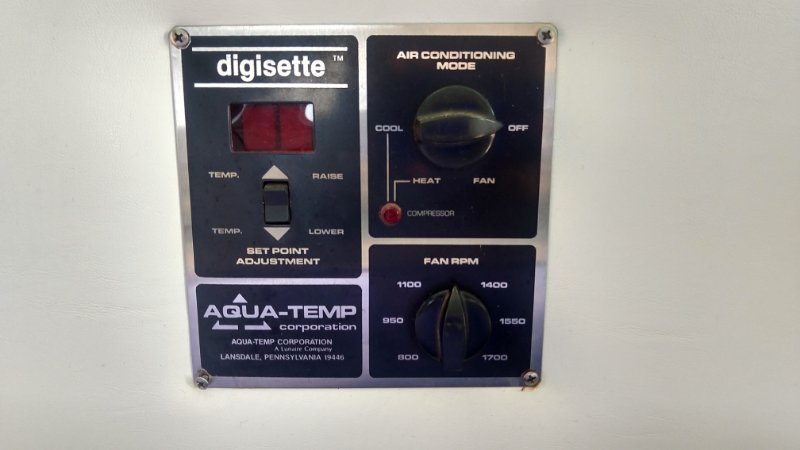

- Old AC system controls
- IMG_20200417_161045456_HDR.jpg (784.7 KiB) Viewed 6851 times

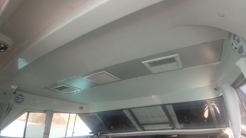

- Salon overhead vents
- IMG_20200417_161025137.jpg (351.71 KiB) Viewed 6851 times

Would you even have room over head ? Likely need a bigger water pump that can pump that high . And you will need to run water lines and a condensation drain . Self contained A C units can be nice just not sure it would be a good fit there .

There is not enough room in the overhead in the salon of a 10 meter sadan to but a self contained marine AC unit up there.
If the compressor is bad just change it out. A new compressor will come with a new thermostat controls. You would not need to put new copper lines in.
Changing out the compressor will be less expensive then any other option. Especially trying to do some kind of retrofit.
If there is something wrong with the overhead AC exchanger we have a complete new one.
