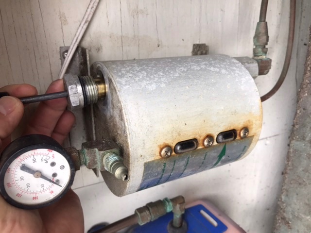

Here is a photo of mine

I tried to unscrew the nut under the black pump and got nervous because it seemed real tight and I didn’t want to break it.
Re: Hynautic steering
That is the fill . But you could fill it where the gauge is , it would be a slow fill .

Well I was able to unscrew the nut under the small black knob pump.... definitely the fill. Thank you!
