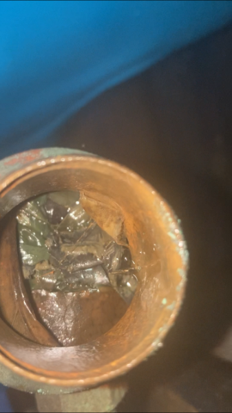

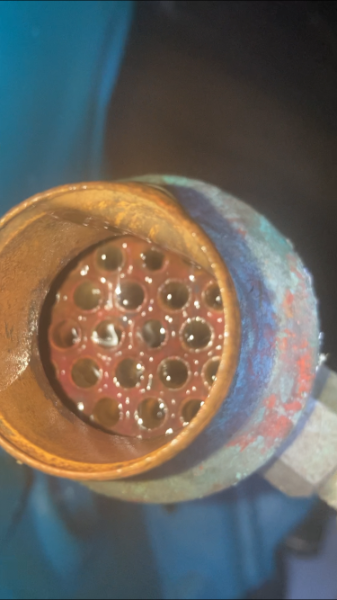

Hey gang,
Just an update if this could help anyone in the future. F32 with 318s.
Per usual, I replaced Impeller/thermostat early spring. Decided to replace both sets of risers/manifolds as well. Took a few slow cruises, all temps were fine. No steam. All good, right?
This past weekend, took her out and ran 3k rpm for half hour. Still had a ton of steam from port motor. Minimal from starboard. Last night I decided to pull apart the Oil cooler. Glad I did! 2 sea strainers are now on order. Back flushed both oil coolers. Surprised at how much more water is dumping from the exhaust.
Woohoo!
Woohoo!
