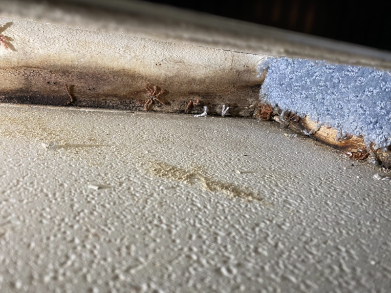

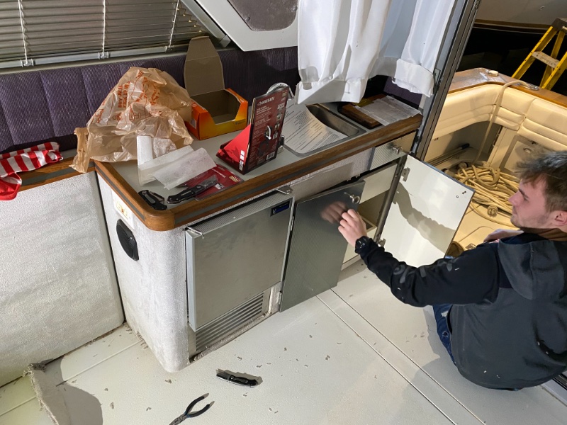

How do I go about removing it, want to see if the leak is behind it.

This may not apply in your case, however many of the internationals featuring MODULAR deck furniture such as wetbars, seating, L-bench seats and other removable deck items were attached with a hand tightened bolt like this:
https://www.trojanboats.net/zencart/ind ... ts_id=1662
On the 10 meter wetbar the fridge/icemaker must first be slid out to access one of those fastners
Dunno if this will help, hope it does
Re: Removing Bar. 85’ 11 Meter
The Ice maker will need to come and I believe the cabinet is fastened to the deck/floor .
On the 12 meter, once you pull the icemaker you can jam yourself all the way in. This is also the "pull" pathway for cables from the flybridge. You can also see the backs of the power inlets from there.
