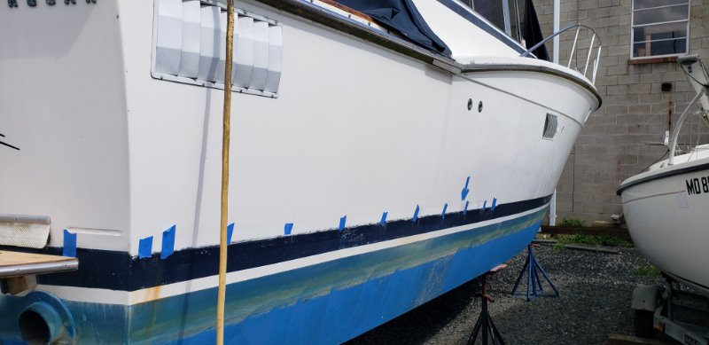

As I began to remove it, it became obvious that it was connected to the boat by bolts coming from inside the hull and behind my fuel tanks. These are not possible to reach without removing the engines and fuel tanks, so I used a Sawzall to cut the bronze bolts next to the hull. Unfortunately, some of the bolt heads were stuck in the hull and I was not able to knock them through with a hammer and had to enlarge the holes with a drill to get the bolts out.

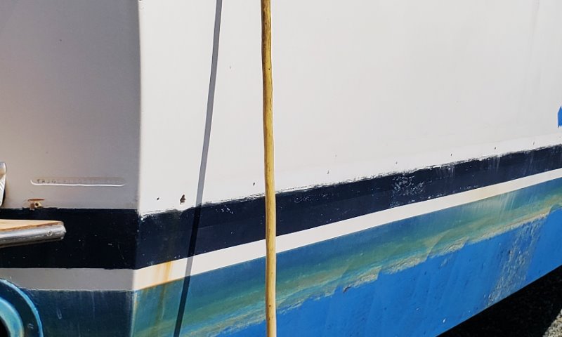

Once the holes were unobstructed, I drilled them slightly larger to make sure there was clean fiberglass to bond to and then used a countersink bit to chamfer the holes so water pressure would not have any chance of pushing my repair into the hull. I then sanded this area of the hull with 100 grit paper so that I had a clean and flat area to work in.
I had an old tube of West Systems Six-10 thickened epoxy that is applied using a caulk gun and used it to fill the holes just above the level of the hull. I was hoping the epoxy was thick enough not to sag, but that was not the case, so I covered each hole with tape after applying the epoxy.

After the epoxy had cured, I sanded each area flat and faired with a polyester fairing compound. I also went around the boat with a die grinder and a fine bit to prepare all the nicks and cracks before fairing them.
The next step was to sand and then apply tinted gelcoat to each area. I put three coats of gelcoat on, but struggled with it kicking in the cup before I finished each coat. Not to mention, that my gelcoat matching skills are somewhat lacking which became evident when I added a little too much brown tint and could not get it back to the correct color!
Even with three coats of gelcoat, I ended up sanding too much and the repairs printed through. With only a few days until launch, I bailed on the gelcoat and applied some one part poly paint that allowed me to cover the repairs and lightly sand for a barely adequate finish. At least it is just above the waterline...

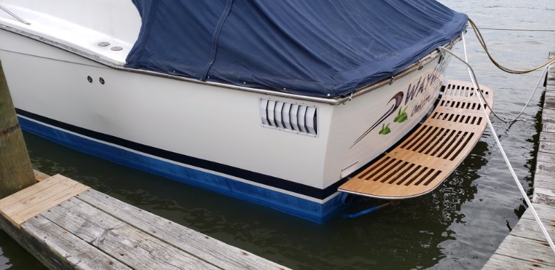

After bottom painting, I taped off the boot stripe and applied primer followed by a couple coats of paint. I am quite happy with how it came out and some of the boatyard workers commented that it makes the boat look more modern.
