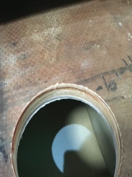

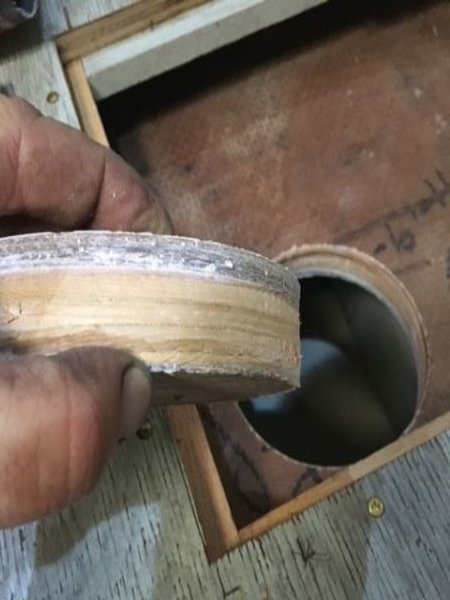

I drilled a hole and installed an access cover in mine a couple years ago for cleaning and inspection purposes. I have considered putting in a level indicator, but haven't done so yet. I will tell you this, if it's one thing Trojan didn't skimp on was the material in building a water tank. I mean look at the pics. That thing was about an inch thick.
Water Tank_2.jpg (40.07 KiB) Viewed 12532 times
Water Tank_1.jpg (39.69 KiB) Viewed 12532 times
