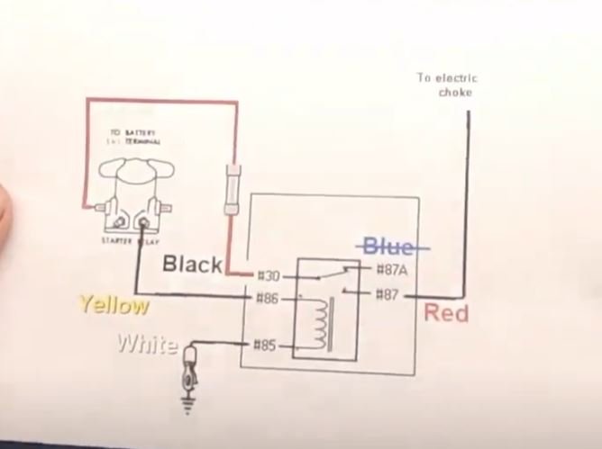

Im thinking of creating a fused relay swith to power the choke from the starter solenoid.
choke relay.JPG (21.26 KiB) Viewed 17797 times
2025 Gold Support
2025 Gold Support
Posts: 12748
Re: Edelbrock Carb Choke Wiring
It does not show the solenoid wiring, But I believe the terminal you're using to activate the relay goes to the + side of the coil. Full 12 volts cranking, lower voltage running as it feeds from the coil after the ballast resistor. Will the lower voltage keep the relay on? Would the relay draw much less than the choke coil heater? I don't know but I bet it's close.

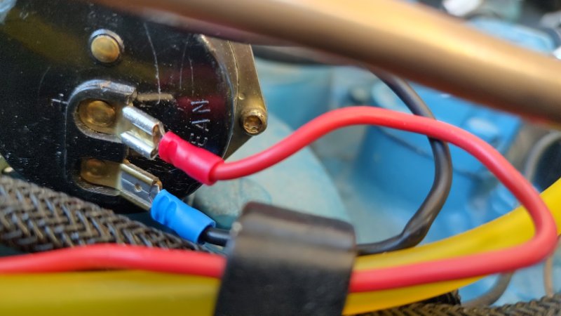

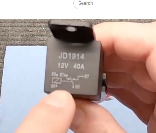

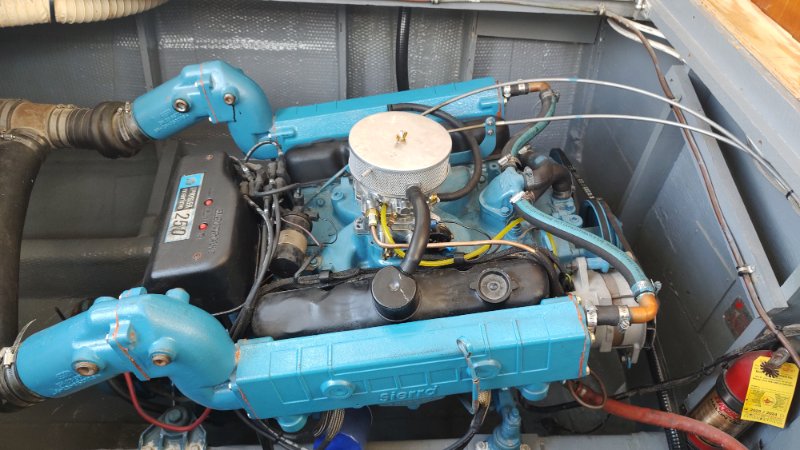

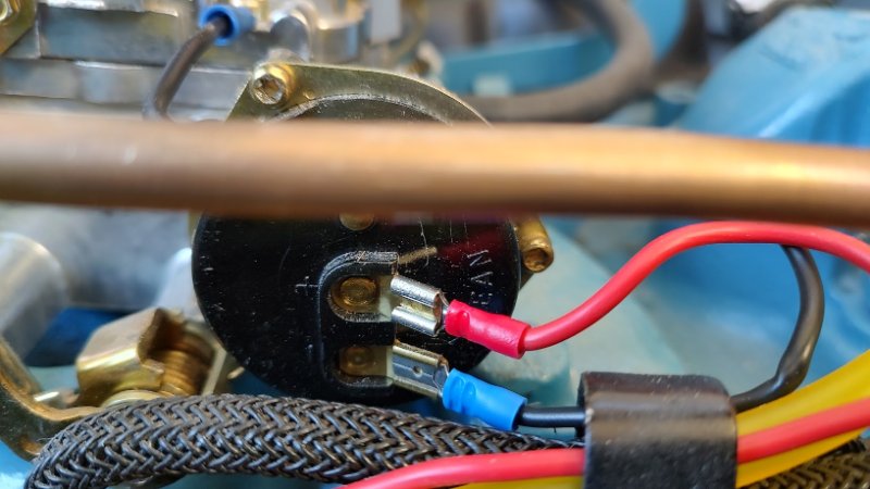

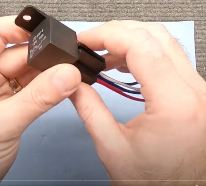

So I built two harnessees based on the photos I attached for the chokes and they worked great !
