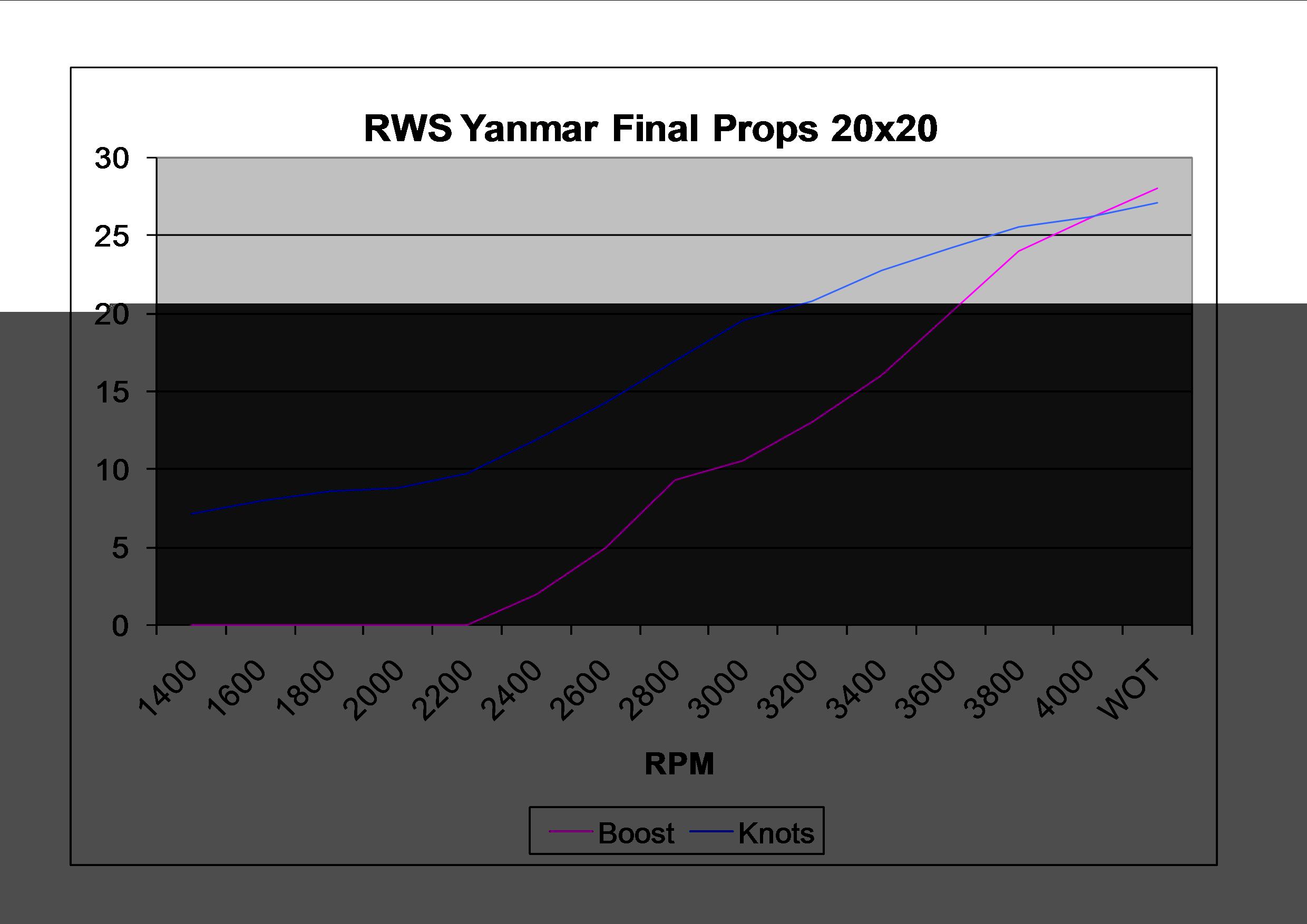

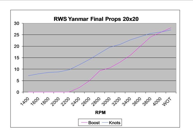

I can't comment on the smaller diesels, but here is the performance chart for my 6 cylinders (if I can figure out how to post it correctly)
Re: Interesting article on 10 meter diesel repower
o.k.
so I need some remedial Forum "special help"
put me in with the dumb kids, O.K. ?

Let me try
- 2025 Gold Support
- Posts: 12734
I notice you numbers are close to the same 170 hp ( speed vs rpm) I thats why I don't believe there Numbers , I also ran them on Boatdiesels calc. before there a pipe dream .
- RWS Yanmar Chart 2.jpg (32.65 KiB) Viewed 4219 times
