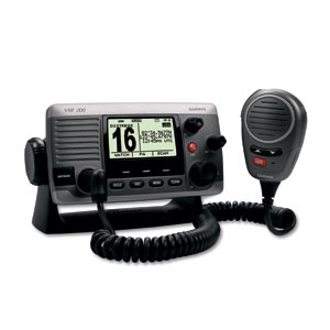

I bought 2 Garmin 200 VHFs.
https://buy.garmin.com/shop/shop.do?pID=28721
They are linked with my garmin 7212 plotter and garmin auto pilot.
I couldnt see buying a vhf that wont link to your gps for safety reasons, especially going off shore even a couple miles.
An AIS box will be my next purchase.
https://buy.garmin.com/shop/shop.do?cID=250&pID=63743
"Add a new level of safety and convenience to your vessel with the Garmin AIS 600 transceiver. This black box AIS transceiver allows you to receive AIS target data as well as transmit your own vessel information to other AIS receivers in your area"

- garmin200.jpg (12.2 KiB) Viewed 12008 times
