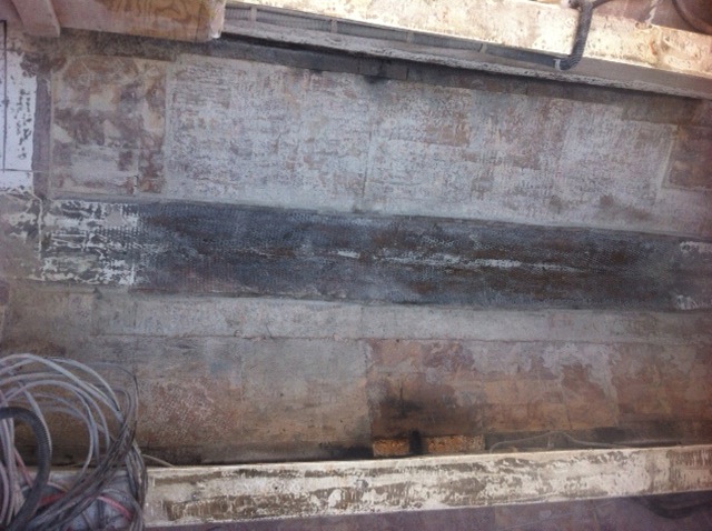

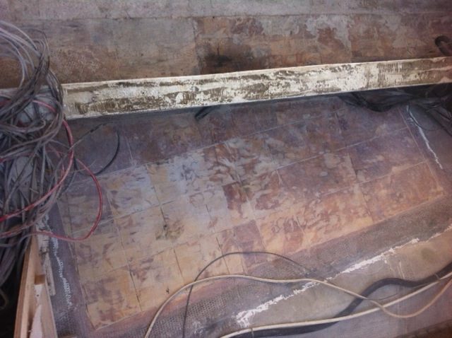

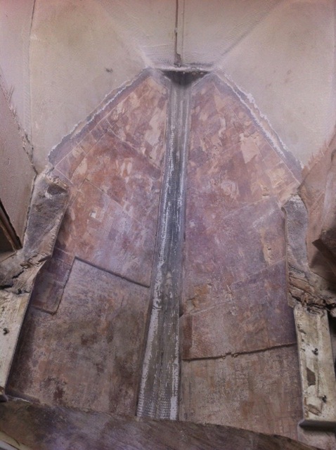

Here are some pics of skin removed and balsa fully dried. I removed some balsa, but left most of it intact. Despite being wet, balsa was not delaminated.Most of the wet Balsa was under the water tank and the bow. All through-hull fitting were very well sealed and even after 23 years not a drop of water seeped in. The water came in from the hull. This boat was kept in water for a fairly long time without regular bottom paint. The hull has no blisters some gelcoat damage, otherwise it is in an excellent condition.

welcome aboard. is the hull, above and below the waterline actually balsa cored and not solid glass? YIPES!!!!

I can only speak of 12 meter International. Its all balsa core above and below water line. The fiberglass work is so good that a hammer and even moisture meter cannot detect wet balsa unless its soaked in water. I had to drill holes both sides of the boat hull from the stern to the bow. I am happy I did that as the balsa was all moist. Its dried up now. We have a hot climate 38-40C now a days.

wow shams, thanks for the information. i never stop learning from this site. i've never seen a hull 'sandwich' before. how did you get the top layer of glass off to expose the balsa core? and you are so right with the comment about the layup. it's actually pretty good considering the time frame in which these boats were built. keep us posted on her progress.

Its a tough job. Had to open up the entire boat. Had to remove the galley including all accessories, removed the guest stateroom and the forward stateroom. Removed the floor and the fresh water tank so that the hull was completely accessible. Used a cutter,hammer, chisels and a crowbar and removed one sqt of skin at a time. Its very hard to take out larger pieces at one time. The skin came out with lot of effort; only in the area where balsa was very wet it came out easy.Area that was only moist and not wet the skin left a layer of glass attached to the core which was grinned. Hope this experience is of help.....aaronbocknek wrote:wow shams, thanks for the information. i never stop learning from this site. i've never seen a hull 'sandwich' before. how did you get the top layer of glass off to expose the balsa core? and you are so right with the comment about the layup. it's actually pretty good considering the time frame in which these boats were built. keep us posted on her progress.
