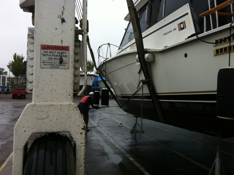

All things being equal - the gel on the late 70's vintage Trojans can put up / keep up an awesome shine. Here's what my hull looked like at end of season this year (overcast, rainy, dreary day). I just love how much the fenders and the guy power washing the bottom still reflect in the hull after all these years!
Haulout 2013.jpg (151.34 KiB) Viewed 6122 times
I use Meguiar's products - their #45 Boat/RV Polish, and Premium Marine Wax. Both are applied/buffed by hand because I found I couldn't get consistent results with power buffers. Thing start off clean and gum up quickly, plus amount of product used at the start of a pad is way less than at the end of one... So doing it by hand and swapping rags every once in a while works best for me. Roughly 8 hours to polish and wax both sides, plus another 3-4 for the transom, plus more for superstructure.
