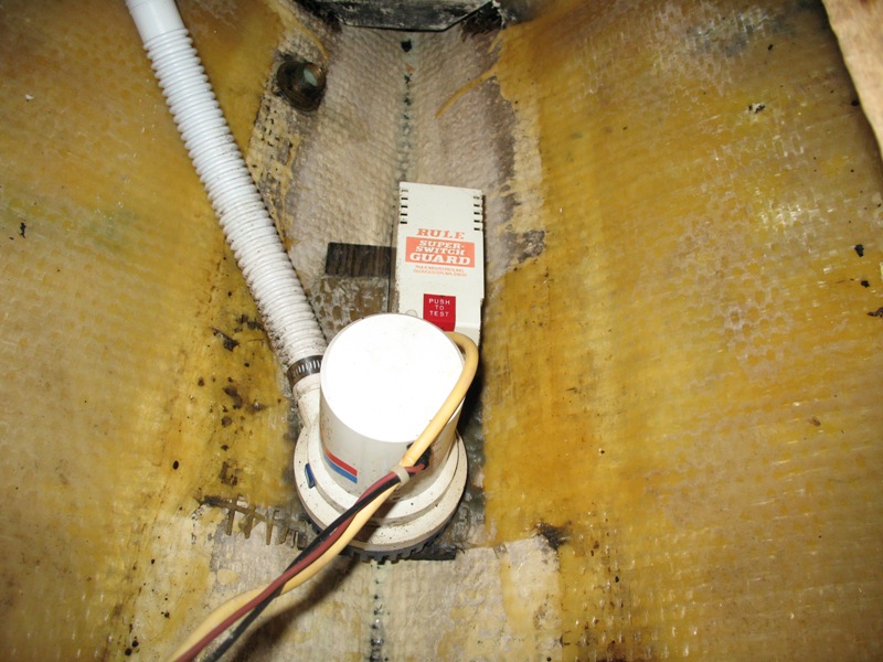

Because of the "V" shape forward, there is often a small pad installed like a 'bridge' (with gap under it for water to flow), to provide a flat surface to mount the pump and float switch. Because of this, the pump actually sits about an inch above the actual bottom. I have some pics of my setup, but they don't really show the pad that well. This one is probably the best I have. The edge of the pad is more visible at the top of the picture, where the un-glassed forward end of the wood is exposed...Commissionpoint wrote:Is your forward pump not flush with the bottom of the hull? Do you have a whole bunch of heavy gear stored under the cockpit deck? Not enough beer stored under the v-berth???

I see your little wood 'ledge' there CM. I am sure I have something like that as well. Can't really recall off the top of my head though what exactly it looks like. I really have no problems in this department, so I generally just take a quick look at things once in awhile just to make sure nothing looks out of whack. I know Nancy had the original Lovett sent out to the factory for a rebuild, so I would imagine my setup is still close to bone stock.
I can snap some pics too I suppose. I hauled last week, and have to go over this week to reblock and cover. Another thing to consider is that its still very hard to get every drop of water out of the hull on the hard because of the way the drain plug is positioned in that area. The keel plug installed by the PO really helps me in that department, and thats why I reblock after a week or so of having it nose down when I haul.
