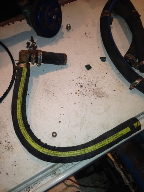

Spent about 2 hours removing the raw water pump, alternator belt, thermostat housing, hoses, u-cooler, and eventually the circulation pump. The U-cooler is one of the older models that has the water outlet to the thermostat at 90 degrees to the oil nuts. (Like 97555 here: http://www.mrcool.us/97464-crusader-heat-exchanger.html)
The previous owner used a long line of hose coiled in a circle and a 90 degree elbow to make the connection between the thermostat and the u-cooler.
IMG_2721 (480x640).jpg (196.04 KiB) Viewed 6999 times
I don't think the proper formed hose (http://www.marinepartssource.com/newdet ... fgno=97861) is going to fit because it is meant for the U-cooler with the 45 degree outlet.
Anyone run into this problem already? I'd like to find the correct formed hose for this to eliminate unnecessary fittings, hose clamps, leak points, and clutter.

In the picture, you have shown, a raw water pump and not the circulation pump...so the R/W pump failed?
srokag44
Posts: 98
Location: Merritt Island, FL
Re: Circulation pump failure
Post by srokag44 »
No no, sorry the picture was just supposed to be of the terrible hose and elbow. The raw water pump is fine... I just rebuilt it a few months ago. The circulation pump is what failed.

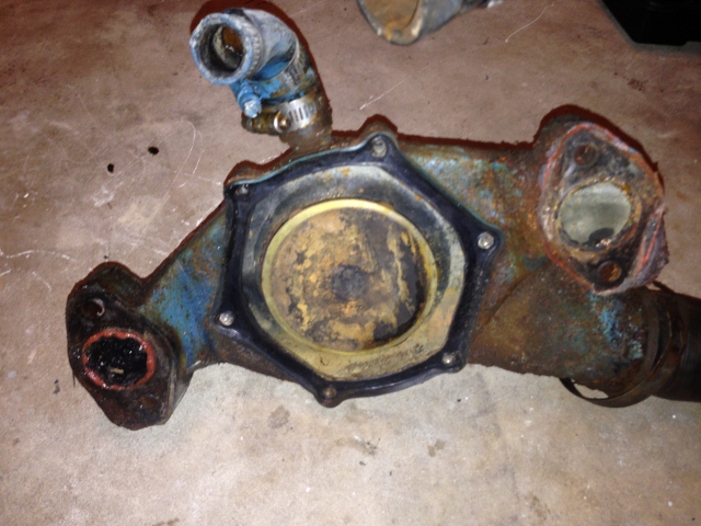

Here's what the circulation pump looked like. A lot of corrosion on the impeller. Haven't taken it all the way apart yet but I'm sure what is left of the bearing looks similar.

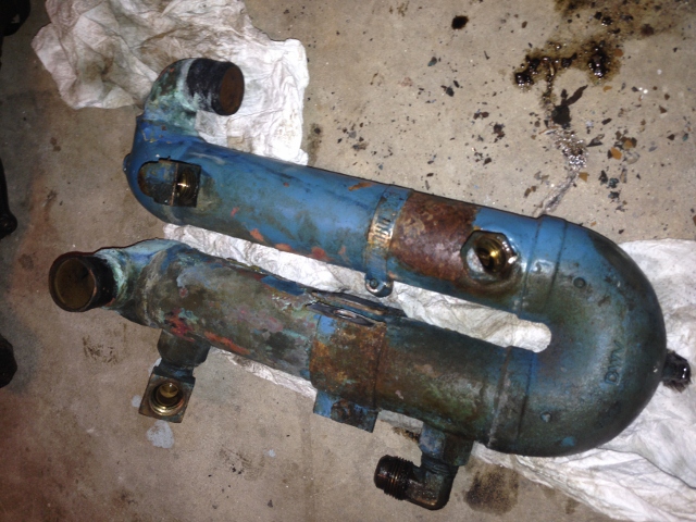

And here is what my U-cooler looks like. The water outlet to the thermostat comes off at 90 degrees instead of 45.
IMG_2723 (640x480).jpg (218.75 KiB) Viewed 6943 times

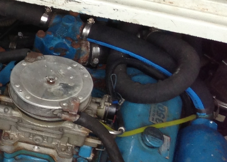

How was this supposed to be plumbed to the thermostat? So I don't have to do something like this:

The one on my other engine has the outlet at 45 degrees like the drawing because I replaced it about a year ago. I could do the same for this one but for $300+ I would rather re-use it. I can't seem to find any information on where these 90 degree outlet versions were used.

I hear ya---I have much the same issue as can't get original moulded hose so have to get inventive---maybe a 45 degree 1"1/4 plumbing fitting and a couple of pieces of the hose you already have will get you to the thermo housing inlet---Mike

Yeah I like to minimize failure points (extra hoses, fittings, and clamps) but it looks like I have no choice here. I guess I will just use a big loop like what has been on there.
