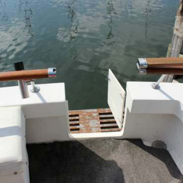

I was thinking of cutting out a swim platform door thru the transom, I have added a picture I found on the net of an F32 with the door, I would like to know if there was an option to have these doors done at the factory when the boat was ordered or these doors were added on by the owners. Was wondering about the integrity of the transom wall and if anyone has done this, I know Paul has done this upgrade on his F26 and it looks Fantastic, he has a single engine, as you all know F32 has 2 engines so was wondering if this would make a difference. Any advice would be great

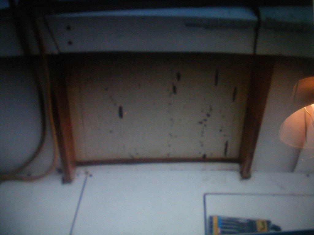

The first cut it the hardest .mikeandanne wrote:Would be nice to see that from the other side with the door shut and railing down I think......If I had half a clue how to do the finish glassing ,gel coat etc I would take the sawzall to ours, what a great addition imho...Mike
I boxed/framed in the door section . The framing in also caused the inner liner to become fastened to the transom making it stronger . I have not seen any signs of flex . I also know of a F32 that did one a did not box it in with no issues . remember your only cutting part way down ( to the deck )captainmaniac wrote:I think there is a certain amount of structural integrity that has to be factored in. The transom is pretty thin I think, and the 'boxy' aft section is part of the structural strength. If you want to cut a chunk out of the transom, there may be some things you need to reinforce.

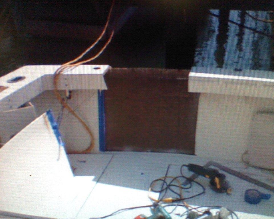

Re: Thoughts and Opinions
Inner liner cut out , larger then the door , note the upper part is all ready cut
Framing in the door . Notice the transom is not cut yet ,What you can't see were the deck is fastened to the transom with wood and west system and glass . What you can see is marine plywood .

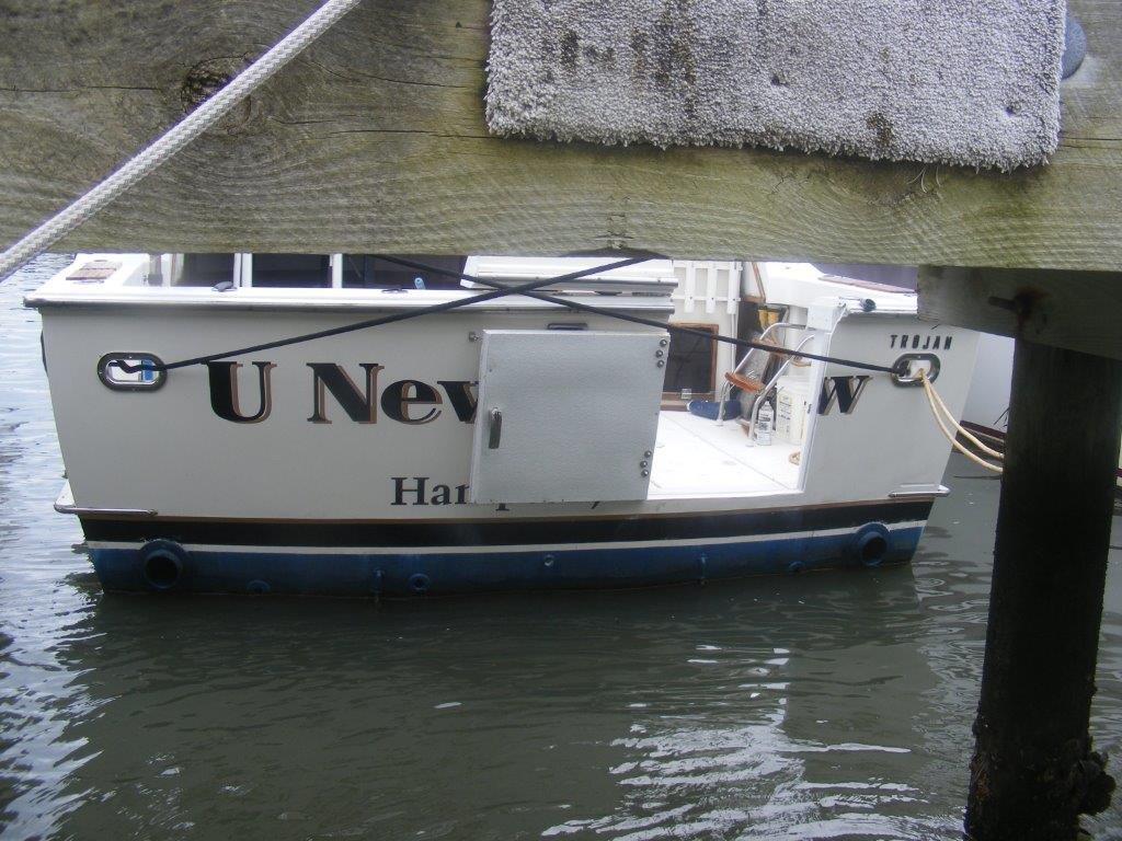

Of all the things I have done to this boat , this has to be one of the most useful . It makes it much easier for Her to get on and off the dingy and floating docks . I have no regrets
Only the outer skin that frame also to hold its shape and make stronger (before the cut ). The hawse pipe has nothing to do with the door it self . The hawse pipes are where the ropes go thru . You can see them in the last photo , sorry about the poor first 2 photos they were from my flip phone .
Ok Paul come on up and make the first cut then I am committed as you say lol, do you have a picture of the door when it is closed, also I like how you have the taft rail that is hindged and closes on top, again thanks for the input.
I am sure I have a pic somewhere . Taft rail ?? Do you mean aft rail ? The F36 does not use a railing on the stern as the cockpit is deeper . I do not recommend removing it on the F32 to easy to fall over .Happy Ours wrote:Ok Paul come on up and make the first cut then I am committed as you say lol, do you have a picture of the door when it is closed, also I like how you have the taft rail that is hindged and closes on top, again thanks for the input.
Craig
On the door the top part swings up and over ( hinged ) and the door swings open .
