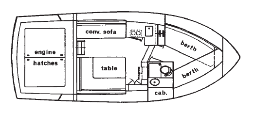

Dante I can see why you are trying to sort this out here are some ideas.
To start I have no idea what is in your boat but I can guess at some weight.... 3 to 4 sheets of 3/8 ply for cabinets ,120 lbs...then a full 5 gal water heater about 60 lbs for a total of 180 then a sink and counter top ,cushions etc so all that stuff missing adds up......these boats are designed to sit fairly level at rest.......another thing, until you know for sure those tank Gage's can be inaccurate especially in round tanks.....Mike
- captainmaniac
- Posts: 1924
Re: F28 List
Here is what the factory layout of the F28 Sedan was fro m'76 to '79.
